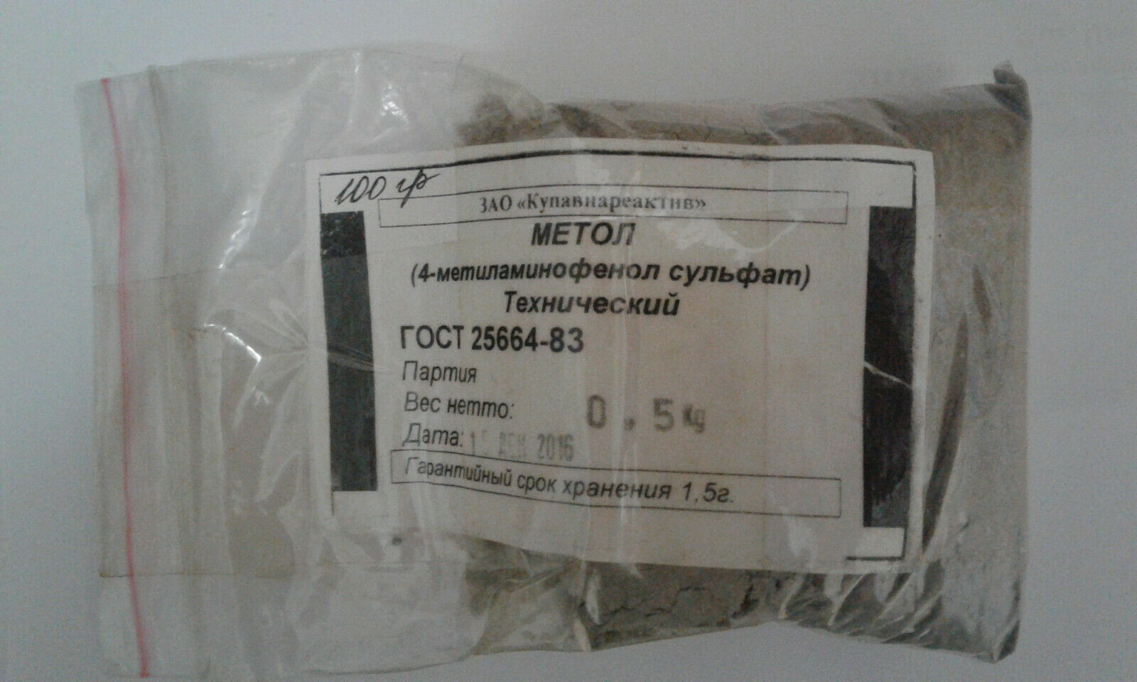

I am not so sure about the color of the powder !
metol powder is loking that way!
But I also remember a seller a year ago who offered metol with a cast (brownish red) if I remember right!
hart to identify if it was the same from this here - it was a seller located in the "Ucraine"!
But I also remember I bought perceptol (Ilford) and it was originaly dated 1983, 1987, 1989!!
All of that metol parts had a cast ! But it worked perfect!
So it may be your powdered metol (with color cast) saw bad storage and is oxided!
But do you know how metol has to come properly in solution?
