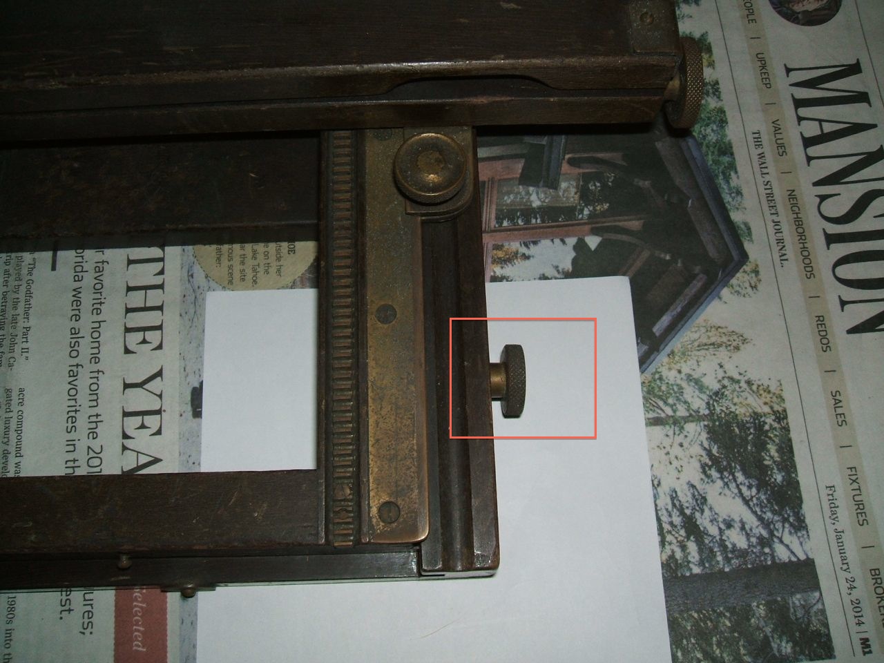

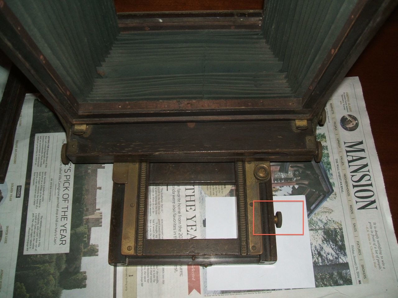

Attached are two photos of the back end of an Ansco 8x10 view camera. Could someone let me know if the knob in the red rectangle is intended to act merely as a 'brake' on the sliding truck or is it intended to act as a lock? Mine acts only as a brake or damper but I would be curious to know if this is correct!
Best,
Jon

What's the difference between a brake and a lock? Never seen one in my life. Looks like a nice camera. A brake IS a lock Probably works by simply warping the track locally. It's a lock. (or a brake)
I just got mine a couple of months ago to rebuild. I just took a good look at the screw and it pushes against a metal strip which clamps the movable rack assembly. I can see where the wood on the rack assembly has compressed over the years. there is a collar under the knob where the threaded rod is pinned to the knob. The bottom of the collar now rubs on the camera body so it will not tighten properly. I substituted a machine screw for the original piece and it clamps very easily. A really fast easy fix would be to put a ball bearing or short metal rod under the knob/screw; or use a size 10 32 NF screw as a replacement.

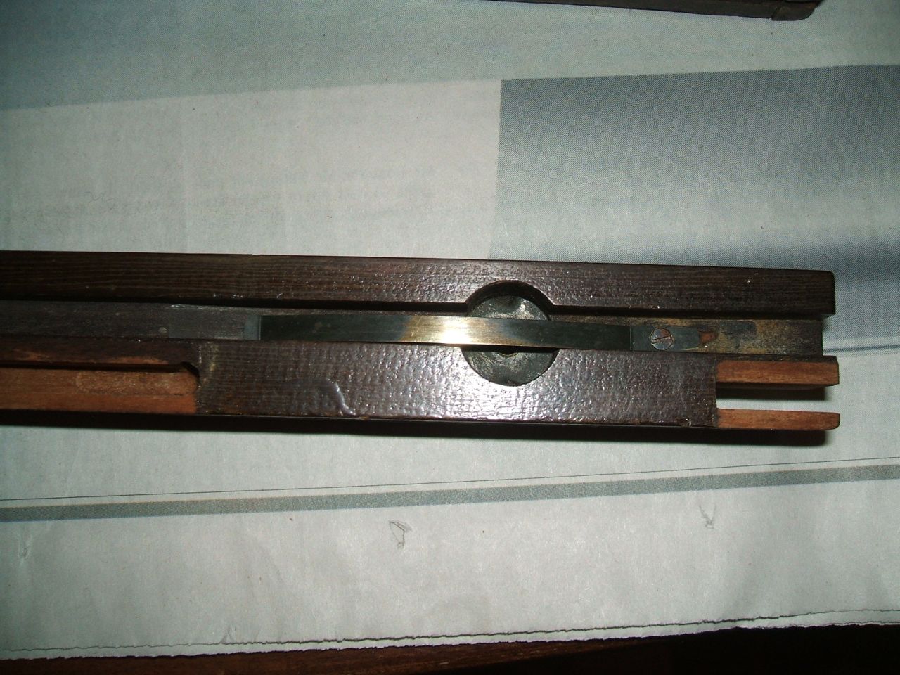

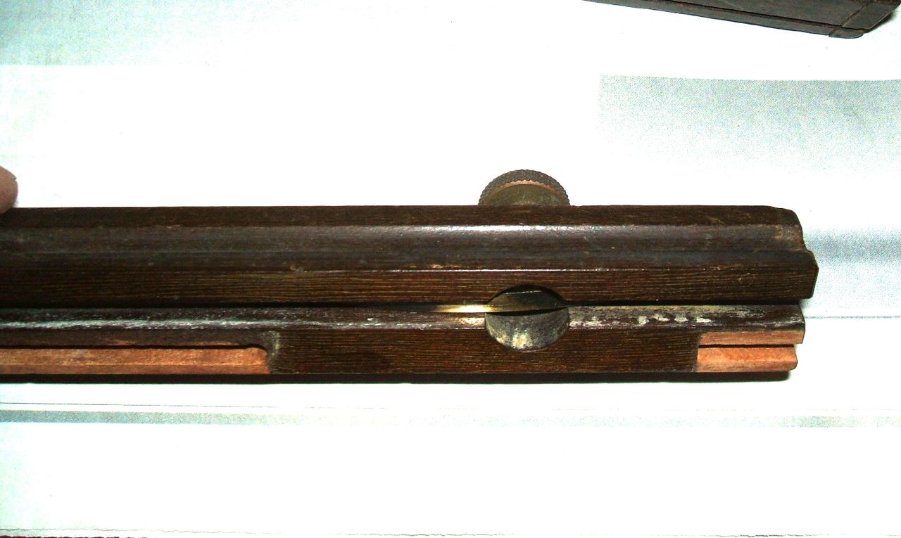

Hi there Tessar - These photos should give you a good idea of how things work in there. You can see that as the knurled screw is run in by the user, it impinges upon the metal strip nestled in the track itself. The strip then provides friction as the rail slides by. The friction is of course variable depending on how much the knurled screw is run in.
Also, if your screw is stuck, there should be no harm in backing it out counterclockwise. It is designed to back all the way out and detach from the camera if needed. If not hand loose, just wrap the knurled part in rubber or something to protect it and give yourself a little leverage via pliers or a small strap wrench. Should pop free and behave well ever after.

Thanks, Jon. It works like you said. I'm just a beginner at LF. The camera is in unbelievable shape for 60+ years, perfect bellows (most likely replaced). The previous owner had been kind enough to strip the ugly grey paint and refinish it beautifully. When I got it I searched the internet high and low for an instruction manual, but there probably never was one. I'm sure it wouldn't have been needed by anybody who bought one of these in the late '40s. I was also lucky to find an old Ries tripod with a 6-inch platform, just right for the camera.

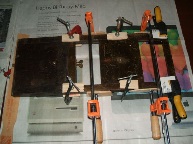

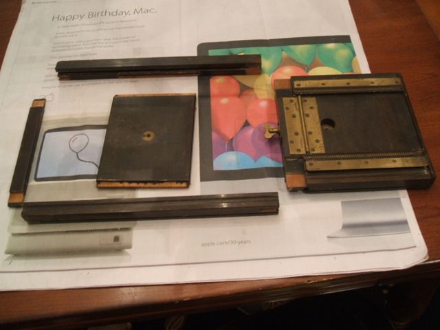

Jon, I once had one of these beasties that had shrunken so much the thing was barely a damper let along a brake or a lock. This will sound more extreme than it really is. I took a heat gun and heated the glued joints until I could take the base apart, removed some material, and glued it all back together so that it functioned properly again. Not nearly as difficult as it sounds. Took an hour or so to do, and I'm mostly a wood butcher. Meaning a chain saw is my tool of choice for wood.
I'm on it! A friend was in town and happened to have a nice little 12-inch Stihl in his truck so we went after it. All is well now. Thanks for the advice!!
J

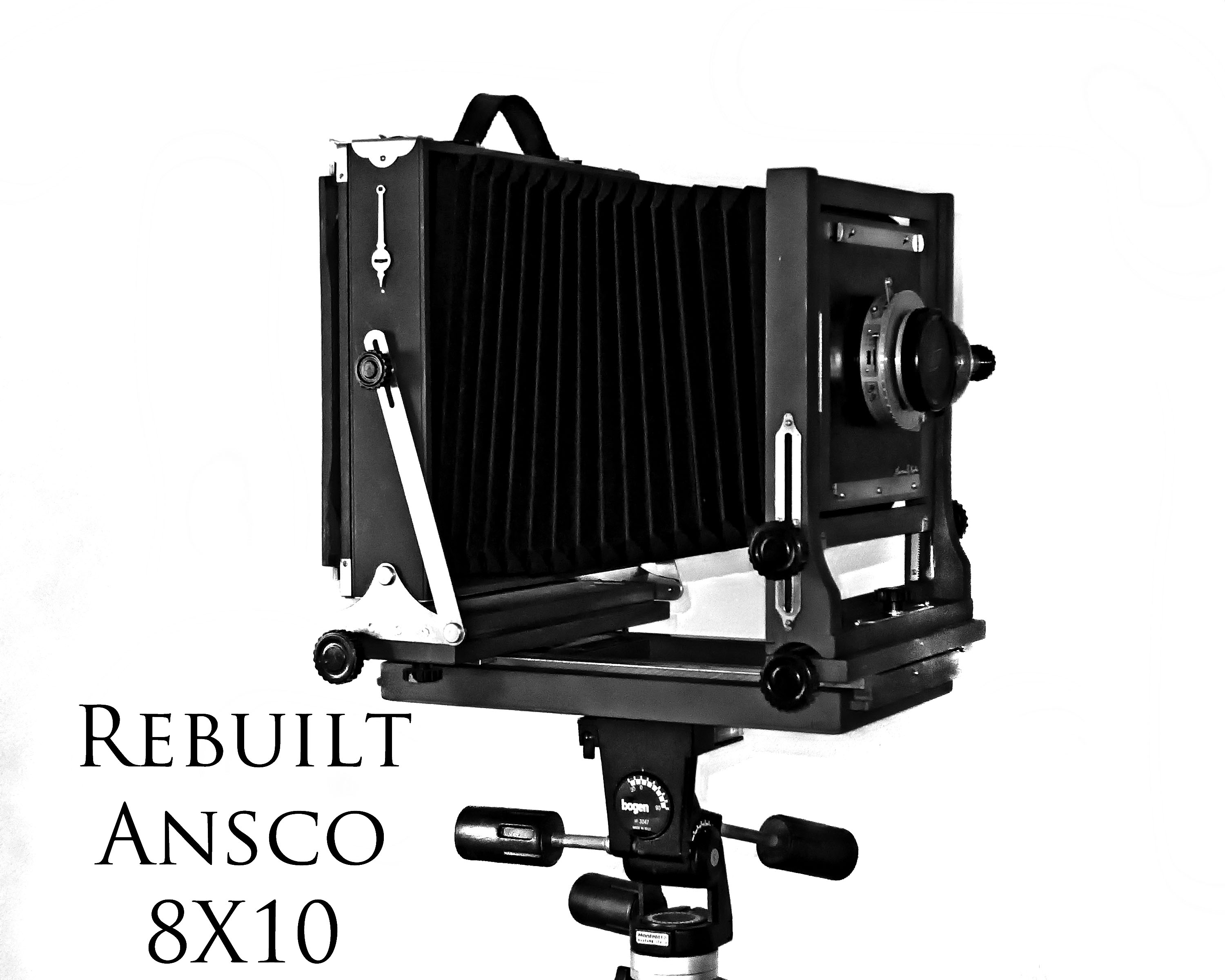

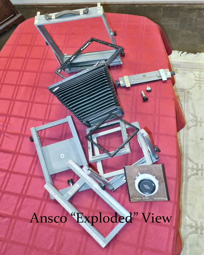

Ansco 8X10 Rebuilt
I have finely repainted and cleaned up the Ansco 8X10 - With a new bellows....
It was not in too bad of shape for it's 70+ years.
