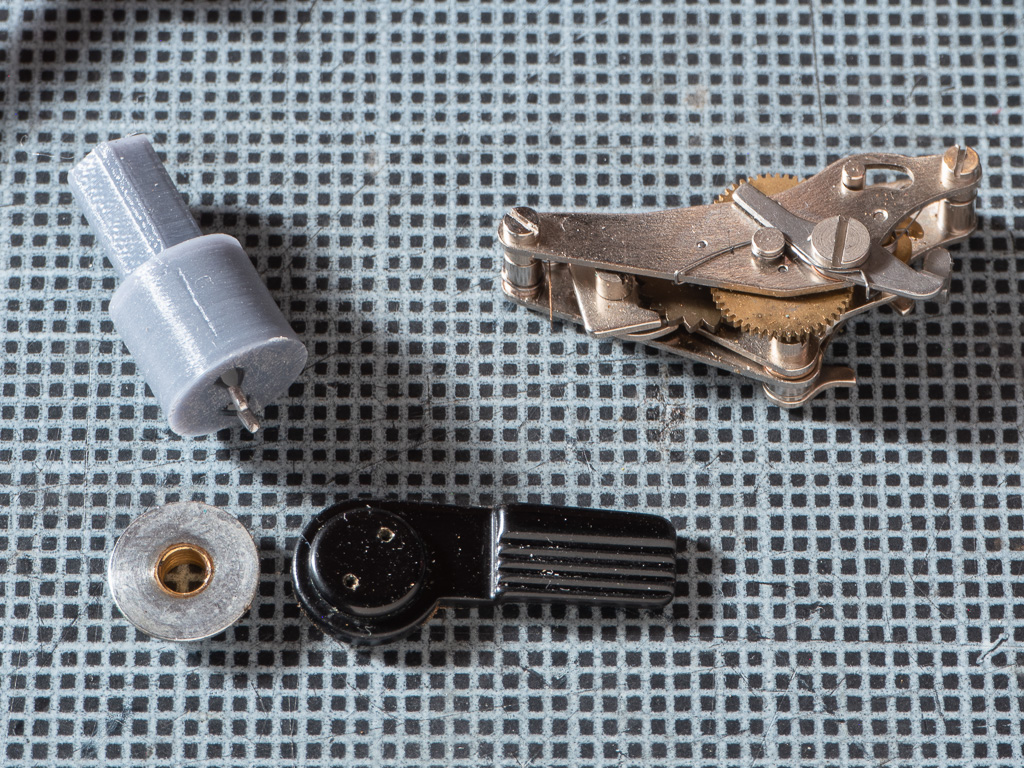

Here you can see part of the mechanics of one of the motor drives in the Nikon F4.

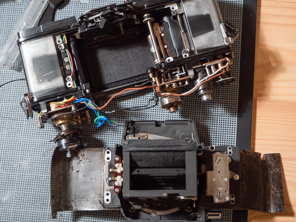

I disassembled my Minolta SRT101 this much:
Initial problem was that mirror mechanism moved sluggishly. There are YouTube videos which show an easy fix of lubricating one area under the bottom cover. And this did help, but IIRC, the camera still seemed iffy. Removing the SRT's mirror box allows great access to shutter rollers, self-timer and more.
Downside is that it also means undoing all of those strings! And it's at times like this where I take a deep breath, and remind myself that once upon a time, skilled assemblers were putting these together quickly! I didn't have the benefit of an experienced mentor, so I had to figure out the techniques for myself, but yes, it can be done.
I do not attempt to disassemble items like self-timer or shutter speed escapements, because (1) they are often crimped shut, (2) there is little need to do so because they can simply be flushed with cleaning solvent and relubricated and (3) if you nevertheless insist on doing so, they can be a real pain to reassemble!
I found that the completed camera had a nice "crisp" snappy action, with factory spring tensioning providing more than enough force.
