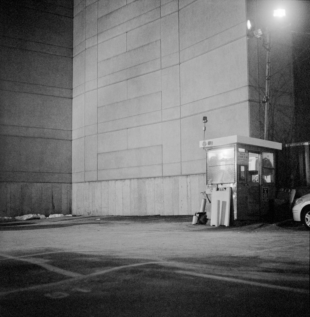

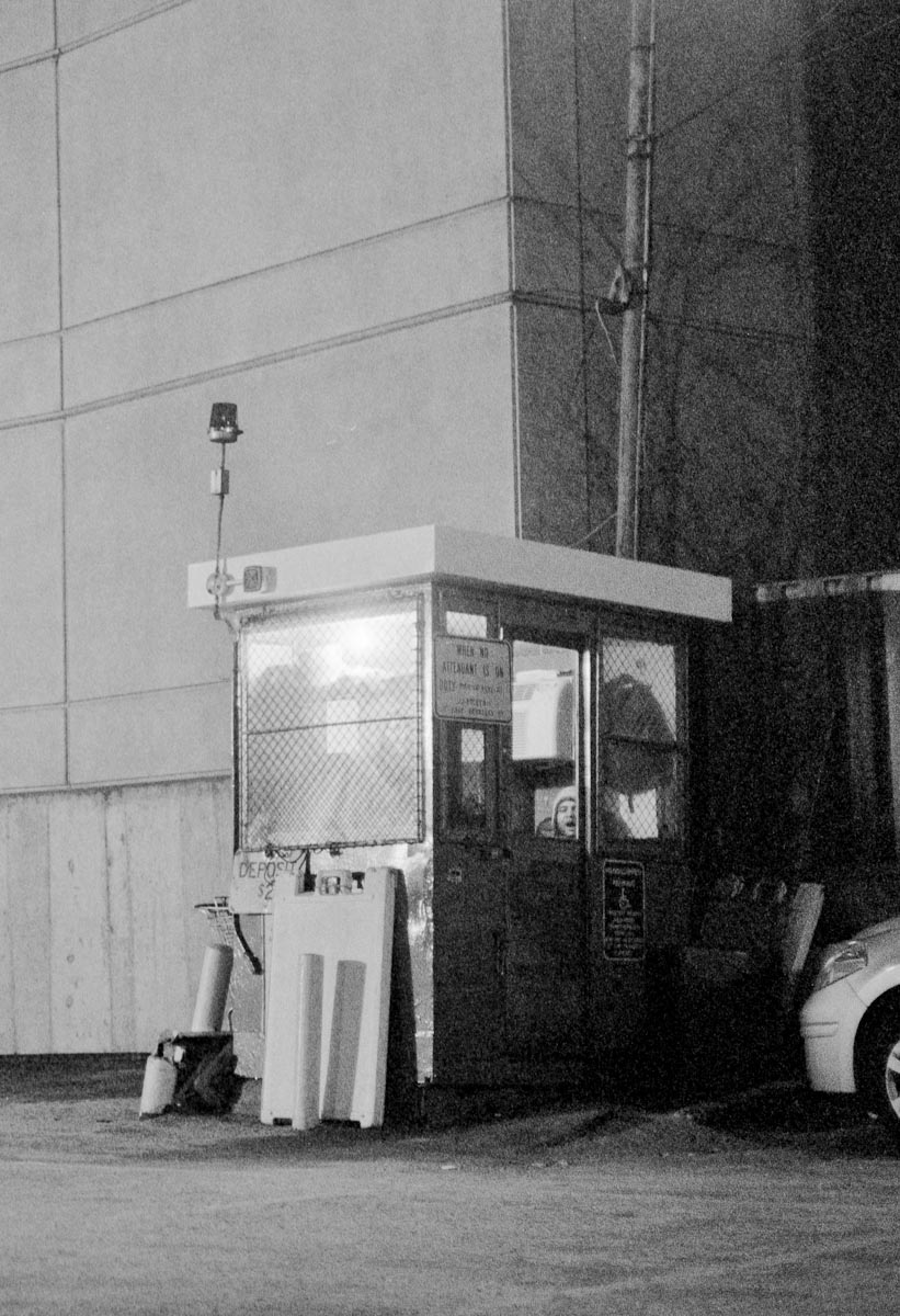

This is specifically for those who regularly shot 400TMY, and now regularly shoot 400TMY-2.
I used to test TMY regularly, and I didn’t really find surprise, but someone gave me a few rolls of 400TMY (refrigerated) but I didn’t want to use inherited material for anything critical, and so I used it to test my newly repaired camera.
I found this particular roll of 400TMY to be extremely grainy, like Kodak Recording film (if you remember what it is). It is grainier than Delta 3200 developed in the same developer. I didn’t overdevelop, and the negative’s density is about right. When I tested TMY before, it was always very fine grained.
I also inherited many rolls of 400TX, Neopan 400, etc., but I actually don’t recall a single incident where the inherited film behaved differently from the film I buy in bricks and cold stored. So, I’m wondering if others observed erratic rolls of 400TMY before.
Now, another question is whether anyone observed any erratic roll of 400TMY-2.
Anyone?
Can't answer the first question, but have never observed any erratic rolls of TMY-2.
Never. Even that 2nd version (or third depending on how you count) was quite fine grained. How was the base fog? Might have had a fairly stressed storage....
No reticulation on this negative.
Attached are a scan of a frame of this neg. The entire roll looks like this. One is full frame 6cm square image. The other is a crop that is about the same as 35mm frame size. The grain is worse than TMZ or Delta 3200.
I also noticed that the speed was slightly slower than usual. Fog level is about usual.
Anyone?

Scanned negs always appear grainier than when printed optically. The possibility of poor storage conditions and age coupled with scanning could have contributed to the overly grainy appearance.
I have never ever had any problem from the film.
That scan image looks either super pushed or underexposed. Do test images in normal lighting.

I actually had another roll of 400TMY from the same source, expired 11/2004, but in uncompromised foil bag. I just exposed this roll in the same camera, same lens, same shutter, same light meter. Processed it identically to yesterday's version. The neg is being dried as I post this.
Scanning the neg indicates to me that this well sealed but expired 400TMY is also grainy, though not as bad as the one from yesterday. The grain is worse than Delta 3200 at EI 1600 (and it goes without saying worse than HP5 Plus).
10 years old HP5 Plus stock works just fine, so does this mean 400TMY ages faster??
