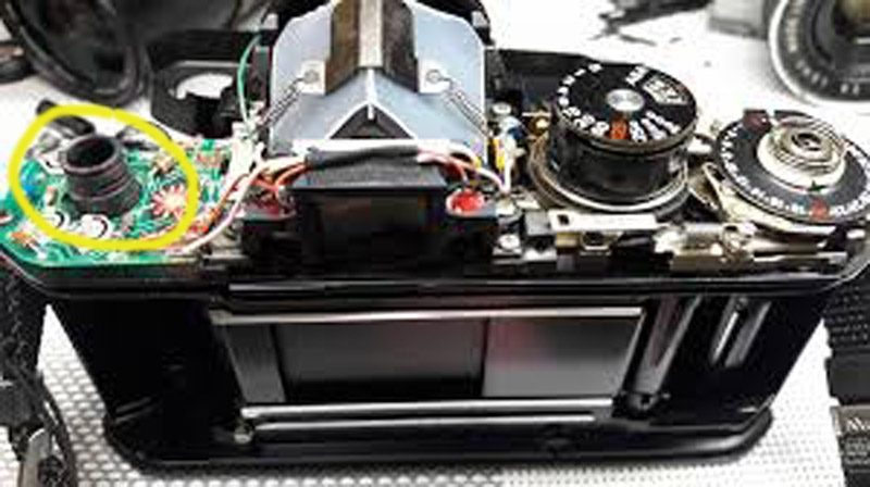

I broke the parts that hold the rewinding knob shaft (see yellow circle on the picture). The upper parts of the sleeve is gone so my rewind knob can move up freely without moving the unlocking lever. My camera is Nikon FM. I can repair this if I have the part, but so far I can't find used cheap part. Now since I also have to do CLA, anyone knows the ballpark cost to replace that part in the shop?

Much depends on the specific camera, but in general, a CLA runs $150 USD + or - in the U.S.
For your repair part, likely the cheapest way to find one would be to find a non-working or beat up FM. KEH's as-is and ugly condition stuff might be good candidates.
The last time I had my local professional camera repair shop do a CLA it was for a Pentax LX and they charged me $80. I think $150 can be a bit on the high side.
I agree with bdial about repairing your FM. Look for a broken camera you can pick up for cheap. It might also be that if you can find a repair facility that's been around for a long time, they might have the part from their dead camera bin that can get you fixed up.
Maybe get another FM that is not broken, save that on as a parts spare.

I suppose that because it is an FM, this a fairly generic camera and parts off other broken /disabled Nikons may be used such as the FE/FE2/FA/FM2FM2n/FE3 . There may be others that could donate the part but all answers here please. I included the FE3 whilst these are now out of production, they were produced long after your FE so spares may be available. From my experience it is the electronics that are generally not available.
It's really not safe to assume parts interchangeability even within brand families. There are some that is and some that ain't:smile:.
I see an FM rewind shaft tube on eBay for $8 shipped from knight-camera
I found the same "sleeve" as BobD: https://www.ebay.com/itm/200995-NIK...146284?hash=item5949e9c46c:g:tJIAAOSwWKtUuezD
There are also listed the FM rewind shaft: (https://www.ebay.com/itm/200785-NIKON-FM-REWIND-SHAFT-REPAIR-PART-USED/383477491307?hash=item59490a266b:g:K6gAAOSwzateeq05)
... and the rewind "pin":
https://www.ebay.com/itm/Nikon-FM-F...363794?hash=item1cdfc5c252:g:b0QAAOSwMvtZXq4v
Not much help there; I'd go with a parts-body too ...

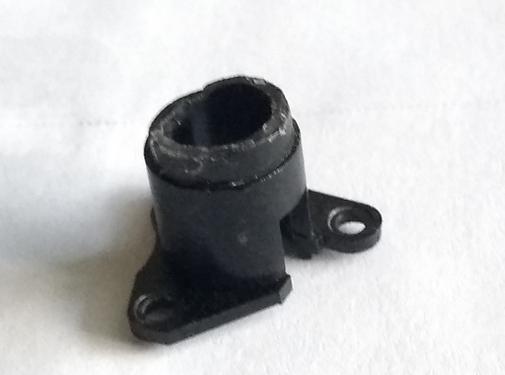

Actually I found an online service shop that has NOS part. The part is called shaft bearing, like this but this is for FM3 :
https://www.ebay.com/itm/Rewind-Sha...811022?hash=item546c09714e:g:eKMAAOSwi0RbGt2t
The part is made from plastic and probably because its old even though its new the plastic is pretty brittle. I didn't use tool to install the top circlip and as result I chipped some of the bearing lip. But it is good now.
I have another problem now, the light meter reads 4 stops under. I tried to clean up the shutter/iso dial but it didn't help. Oh well, but at least it is working mechanically.
