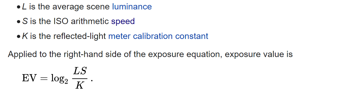

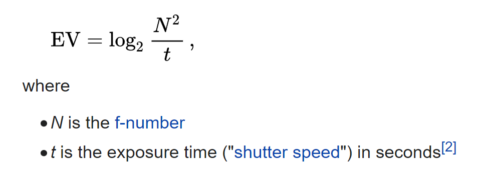

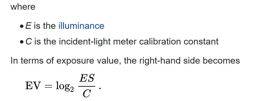

You might find the Wikipedia article on Exposure Value to be helpful. The main problem is you are dealing with Illuminance with one meter and Luminance with the other. You will need to know the Reflectance of the metered surface.
My Pentax digital spot meter's user's manual had a conversion table for an 18% gray card. Without a table, you could possibly get an idea using an 18% gray card and the three equations below to determine the luminance and to cross check the two meters. Note: 18% gray cards don't have Lambertian surfaces and therefore do not represent a perfect diffuser. In other words, depending on how it's set-up, the gray card might not actually be reflecting 18% of the light.
Also, as you can see from the second equation, the EV value will change depending on the ISO speed value even though the lighting conditions haven't. Meters use a fixed value of ISO of 100 to determine the EV number. The f/stop and shutter speed for film speeds other than 100 are determined by the meter's calculator. If you are checking your meters, you will want to use 100 for S.
