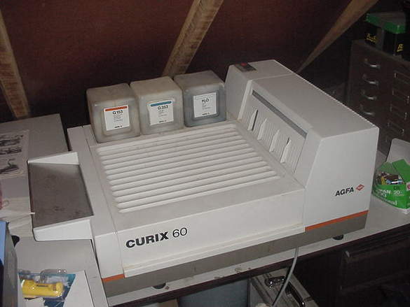

Hi,
Frustating myself and everyone here with my topics, I stumbeld on this machine: The Agfa Curix 60.
It's original a ronthgen machine form a hospital, but it is rebuilt for PE processes. I spoke to the owner, and he told me the minimal voume of chemicals is not enough to make more than 10 prints. So little chemical is required, which is good.
the only thing he also brought up, was that is has three tanks and that colour process requires 4 tanks, but he was not sure about that.
was he right?
Greets Sam

Blix.
You just wash outside the machine.
But how fast does the machine run? At what temp? How big are the baths? The number of prints depend on the chemicals you use. The stuff I'm currently finishing produces quite a few prints from very little chemistry. Other types are different.
game
Aug 10, 2005
368
netherlands
The temperature is adjustable.
The size of the bads I don't know excaxtly, but the owner told me he doesn't feel that this machine is waisting much more than he waistes when printing manually... I should ask the exact volume though.
About the speed, that is not adjustable, but possible it can be set once by modifying the engine. The owner was an engineer and told me that if it's a DC-engine that setting the speed was quite easy, if it's AC, it was not possible.
He would check that and email me on the matter.
So what do you think, could this be a catch?
