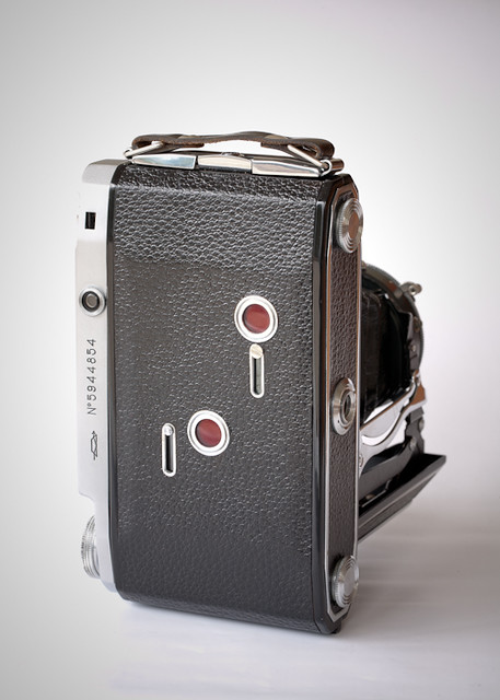

How does the film not get fogged when it is open?
Some of my old film cameras have one red window, some have two, and some have three.
On my old film cameras did not have a cover over the windows, I use black gaffers tape to cover the window to reduce the light that may enter the camera.
6x9cm Cameras
by Narsuitus, on Flickr
6x9cm Cameras
Do u pull back the gaffer’s tape when u advance the film to see the exposure count/when to stop winding?
narsuitus
Nov 24, 2004
1,813
USA
Yes, I remove the gaffer's tape when I need to advance the film. I try to stand in the shade when I advance film. However, many times I am shooting under low-light conditions and need to use a flash light to illuminate the red window so I can see the number.
