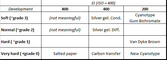

Think in terms of contrast, or as @Stephen Benskin implies, gamma. Overall density isn't useful and mostly detrimental. You want to tailor the gamma of your negatives to the process. So doing a long series of exposures and only two different development approaches will not give what you want. Flip it around; only make 2 or at most 3 exposures, but do at least 3 different developments on those. You could eliminate some of the less logical combinations to cut down the job to a manageable size. For instance 1 stop underexposed and soft development is not a meaningful combination with your purpose in mind, so can be left out.
For clarity, I mean something like this. Note: this is an off-the-cuff example only; you could improve it (lots) by including Stephen's suggestions into it:
Every box that remains empty even after study of all processes relevant to you can be left out; apparently those combinations aren't needed. The two top left certainly look that way; I can think of no process that requires those. In some places you could economize; for instance, the bottom row you could also combine (leave out the 800 and 200 exposures and just stick with the 400) because all those processes will be able to make a decent print on a normally exposed negative that's developed to a sufficiently high contrast. Sure, a salted paper negative will need to be just a smidgeon less contrasty than the ideal negative for New Cyanotype, but the difference is small enough to get away with it for an illustration in a book, I think. And of course carbon transfer can be tailored to suit just about any negative.
By approaching it like this I think you could work out a minimum number of exposure/development combinations that are very close to ideal without giving you years of work. You can also consciously decide where you want to cut corners or, to the opposite, hedge yourself against unforeseen eventualities.

koraks of course the high contrast processes need flat negatives or halftone screens unless you want graphic effects. I completely forgot about cyanotype, gum bichromate, lith and photogravure.
Your graph is very thoughtful and can be helpful with some more detail and experiment results.
