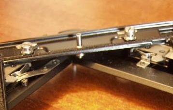

I bet your revolving adapter is missing the pin that drives the mechanism, it sticks out quite a bit and is prone to breaking off when you are a bit careless with the revolving adapter when it's taken off to use a polaroid back. Attached is a picture of the pin, have a look if it's there. It is supposed to go in a hole that is in the middle on the right side of the camera when viewed from the back. You can use a piece of wire to test the mechanism if the pin is indeed missing. Don't touch the red bars to do that, they are very fragile. Mine broke off once (6 months ago) and I received a new one from Mamiya for less than 15 bucks including postage.

The pin is indeed missing. The mechanism does work when I push it with piece of wire. I suppose I could just order an adapter. Was the pin spring loaded? If not I might be able to put a small roll pin into the hole. Thanks very much for the info.

I am not sure if it's spring loaded, I don't have the camera with me right now. It's certainly pushed in by the sloped metal thingy visible on the left hand side in the pic (excuse the description, it's not my first language). It might be pushed back in vertical mode via the mechanism in the camera itself. Mamiya Germany was very quick and helpful with the part, maybe Mamiya in the U.S is similar. I would just give them a call (http://www.mamiyaleaf.com/support_USA.asp) I just had a look at the invoice, it doesn't have a part number on it, I can only tell you it was cheap, 7 bucks exc. tax. Best of luck getting one!
