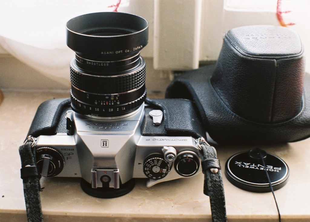

As everybody has said that SMC Takumar is an excellent lens, but desided for the Spotmatic, not the K series.
Another solution would be to get a Spotmatic F that will work with that lens and even offers open metering...personally I like more the combo SPF+ Takumar because they feel slightly smaller than a K body with K lens.
I also agreed the K 50mm f1.4 which is optically speaking similar to the Takumar 1.4 (I think this one is radioactive tough, as slightly sharper) is a better lens than the M50mm f1.4, the M series lenses were designed to be smaller than their predecessors therefore there was a trade-off.
Regarding the Takumar 1.4, the last version with radioactive element and rubber ring is the best 1.4 I have ever had because the CZJ Pancolar 1.4, IMO it's superior to the Canon and Nikon glass available at that time and I like it more than even the modern Nokton 85mm f1.4 AI. This is my SPF with that lens, original Pentax hood and filter.
If you got the Takumar at a good price, keep it. It is excellent. As others have noted if you can find a Pentax Spotmatic F you will have a lovely camera body, much nicer in the hand than the K 1000, plus open aperture metering. Or a less-elegant but cheaper alternative, a Praktica LTL or other Praktica of that series. While a stop-down metering body it is the nicest implementation of stop-down metering I've ever used. See this review of the SMC Takumar f1.4 https://www.pentaxforums.com/lensreviews/SMC-S-M-C-Super-Takumar-50mm-F1.4.html
The members of the L family with the M42-Electric mount and the respective lenses allow open aperture metering too.
Right you are! I think Prakticas are underrated. My Hanimex LTL still works perfectly despite having been bounced off a sidewalk. The bridge circuit meter allows use of 1.5 v cells in place of the original mercury cells.
Yes but the Takumar 1.4 isn't obviously electric, as it has a "fin" to couple the diaphgram, that's the way Pentax implemented the open metering with M42mm lenses. If he's not disturbed by stepping down he can get a M42-K adapter and use it on the K1000.
So, if the OP wants to use the Tak 1.4 at its full capability he needs a SPF, like if you want to open meter with a Sonnar 180mm f2.8 electric you need a PLC, VLC or EE body.
