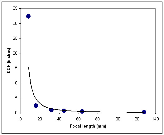

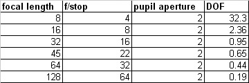

Just to demonstrate what a flipping geek I am, I had to try it for myself.
The DOF was calculated using dofmaster.com, and the parameters were an APS camera 2 feet from the subject. I needed to use this in order to avoid dealing with infinite depths of field.
It's easy to envision a fixed pupil diameter. Just select a constant ratio of focal length to f/stop and you'll get it. So I chose a diameter of 2mm, which occurs when the focal length is 2x the f/stop.
As we're all comfortable with, a diminishing f/stop (all else equal) should increase DOF, and an increasing focal length (all else equal) should decrease DOF.
As you can see here, despite the fact that the physical aperture is identical for all combinations, DOF decreases dramatically as you increase focal length, and this is not mitigated by higher f/stops.
As you can see when you plot DOF against focal length (with physical aperture held constant) DOF asymptotically decreases towards 0 with increasing focal length, and it asymptotically increases towards infinity with decreasing focal length.
So I can conclude that physical aperture in and of itself is not an important determinant of DOF except in relation to a certain focal length. In other words 10mm is not 10mm. Its effect changes depending on the focal length.
You missed my point. Reread my post. If you work the equations, you will see that:
1) depth of DOF increases as the f/stop decreases,
2) for the same image size on the focal plane focal length drops out of the equation and is not a factor for DOF.
Therefore, increase the film speed, increase the f/stop, reduce the image size on the focal plane, or reduce the film size. For this problem only the last two are effective. [You can argue with me, but you will never win an argument with physics. Have you ever noticed that we have thick books on how photons behave and yet those photons know exactly what to do without ever spending any time studing those books. :D ]
You really need to do the algebra on this one. See the referenced web sites for the equations to start from. Typing equations does not work well in these types of forum so this is left as an exercise to the reader.
Unfortunately, diffaction starts to dominate and therefore the theorectical best DOF turns out to be:
~f/8 for 35mm
~f11 for MF
~f/16 for LF
Your mileage may vary.​
