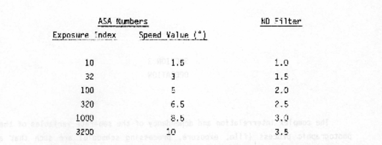

Another good resource is the EG&G sensitometer workbook. It explains how high speed films need extra neutral density filtration, otherwise the sensitometer light is too bright. They may have used an EG&G sensitometer for the graphs. The extra neutral density would explain the right-shift of the 3200 graph.
If that were the case (that they made the graphs with an EG&G sensitometer) you can compare the curves by subtracting "1.0" from the 3200 curve.

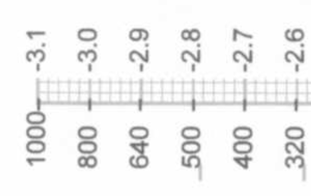

I think I can explain. Here’s the high speed part of my graph paper in meter candle seconds. I called out the ISO and corresponding log mcs. If P3200 could be an ISO 1000 or ISO 8000, the 0.1 speed point when developed to ASA parameters would cross at -3.1 or -3.0 correspondingly. TMAX 400 has no trouble meeting this point at -2.7 but P3200 is nowhere near meeting that speed point parameter.
P3200 is capable of being used at the higher speeds because it has such a special curve shape. It does not get it’s speed at the speed point, it’s getting the speed by working the way you use it.
So my conclusion is... The graph is correct and Kodak deliberately avoids saying ISO speed. Instead Kodak calls it “nominal speed” which doesn’t have an ISO definition.

I found my negatives and I couldn’t resist. There’s a sensitometry strip on the edge.
Now I was trying to help someone get low fog with this film so I developed in D-76 straight 11:30 at 68-degrees F with Benzotriazole. I got 0.22 base and 0.28 base + fog. So that worked (low fog).
Benzotriazole can reduce speed. Since we are talking about speed that kind of messes up this curve analysis.
Anyway I got -2.7 mcs at the speed point, with 0.7 contrast index. That’s literally the 400 speed point.
