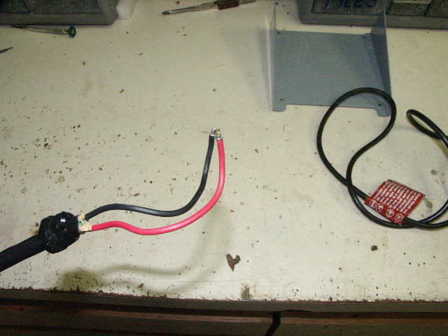

I see in the instruction manual that the power cord has a double outlet. On my power cord there is none. I openned the unit up and find that the 5 prong cord that is next to the power cord on back of the unit, is just two wires comming out of a junction with two screws that hold the wires in. I powered the unit on and put it into the analyse function to see if power was comming off of this junction. I don't get any reading on my multimeter. I would expect it would give out atleast 115 volts to power the enlarger lamp, but it gives nothing. I tried to put the analyser in lamp mode to see if any power comes from this junction and still nothing. I don't know if this is the point where the enlarger should be pluged in. Has anyone openned this unit up and can you tell me which wires the power out to the enlarger lamp is comming from? I would have thought that it would be this junction since it is right next to the power switch and inlet power cord. I don't see any other place to wire in outlet power to the enlarger lamp.

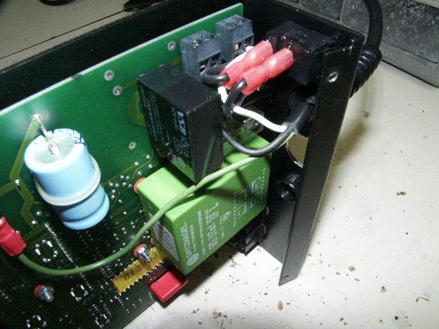

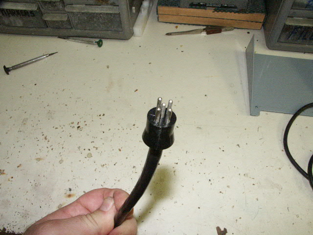

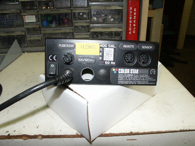

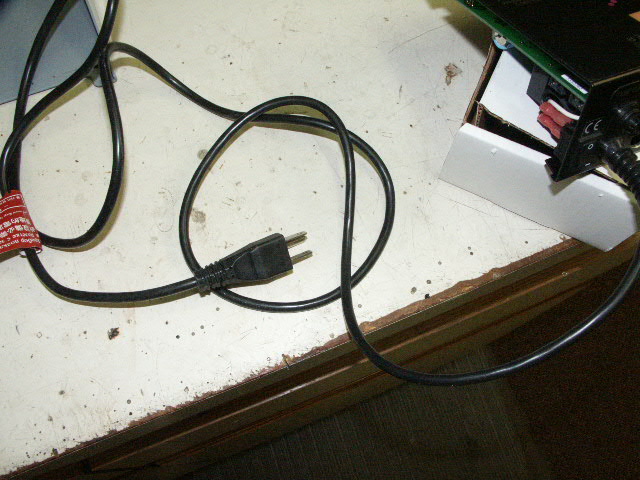

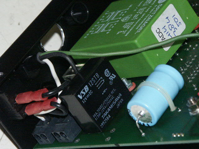

Here are some pictures of the inside and plugs etc.

The main power plug doesn't have a piggyback and the 5 prong cord that came out of the big hole next to the power cord has a red and black wire that connected into the junction block next to the one that the power cord is attached to on the inside of the unit. I removed this wire since it was used to attach to a footswitch recepticle for a Chromega power supply. The junction that it was connected into does not give any power, I assume that it just completes the curcuit like a footswitch. I don't want to jumper the two connections to find out that I am wrong. I don't really see any other place for connecting the enlarger power cord. I only get 120 volts off of the main power switch and the junction block where the main power cord connects to. Does the enlarger power cord plug into this junction? Is there a way to piggyback my plug? I don't have a service manual and I tried Lici but they don't respond and the email link is dead so I assume they are out of business. I tried Omega Satter but they also have never replied to my emails or phone calls. I don't know if anyone else has openned their unit but if someone has can you tell me if there is a place that the power cord for the enlarger is connected to. So far I am stumped. Thanks for all the answers so far but I guess I just don't have the correct model with the piggyback cord and to make one up I need to know how the power is interupted for the enlarger lamp to be turned on and off with the analyse and timer mode.

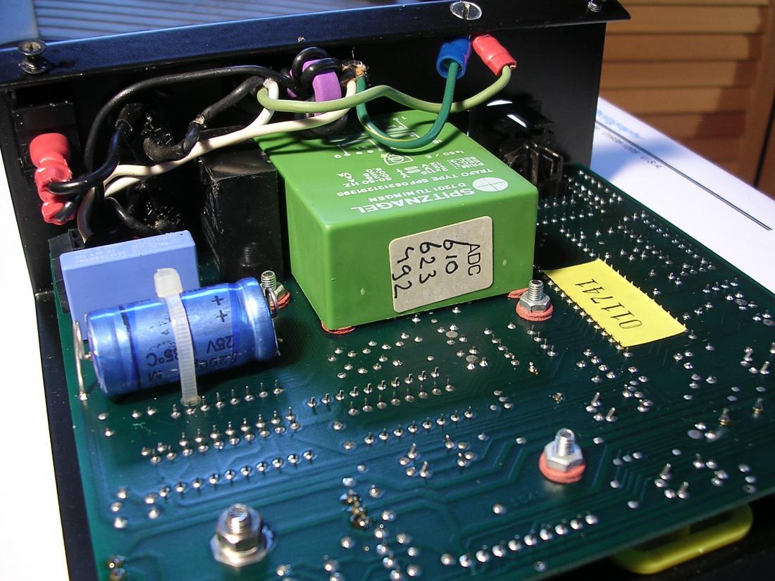

Apparently. this unit has undergone some major and mysterious surgery. Without a thorough knowledge of the intent of this modification, it is beyond my "scope" to give any advice.
Attached is a .jpg of the innards of an unmodified, pristine ColorStar for comparison.
One question: Does this unit operate acceptably when NOT interfaced with anything else/ per the ColorStar 3000 manual?

So far I have not tested it to see if all the functions work. The timer and the buttons all work fine and the probe seems to be working since you can dial out the colorstar. I haven't yet tried to print with it since I wanted to be able to hook it into my enlarger. On the inside of yours I see more connections where my power cord is attached. That must be because of the piggyback setup I assume. I don't have any idea how this unit could be modified to use that kind of a plug. What does the back of the unit look like? Does it have the same hookups for everything else? This unit was used on a Super Chromega enlarger with a seperate power supply and the cord that went to that supply from the colorstar plugged into the footswitch recepticle. It must have taken care of the on and off functions for the enlarger lamp. I don't know. I guess I have an unusable unit for my purpose. Thanks for your help though, I just don't know what needs to be modified to make this work with a standard enlarger.

Figured it out. I was able to jumper the connections to an outlet cord and everything is working perfectly. Thanks for everyones input. I now have a working unit. Glad to see that there are still people interested in this type of equipment.
