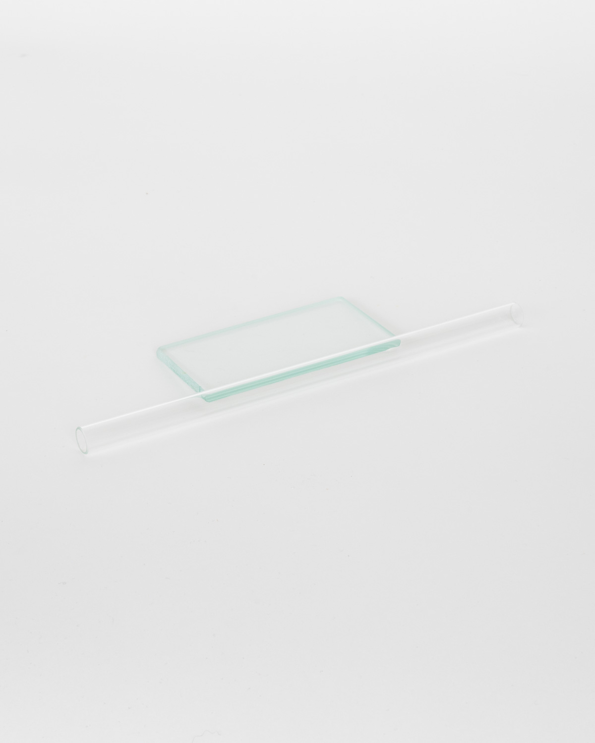

I coat my paper with brushes and I like the process and the look. But I never tried coating rods, so I decided to at least give it a try. Maybe I'll like it, maybe I won't.
But before I purchase, I have a question regarding size. I've seen rods in the sizes of 7, 10, 11, etc... but these are the sizes of my papers — 5x7, 8x10, 11x14.... What I usually do with the brush, is that I leave around 1/2" border on each side of the paper, so if my paper is 11" wide, the print will be 10". And more or less everyone I've seen or know, does this way, leave the borders.
How am I able to do this with the rods, if the width is the same as the paper? Obviously, I can get larger paper, but that's not what I want to do.

Not sure if I understand what you mean, but there's no requirement that the rod is the same length as the paper. You can generally only coat a band that's slightly narrower than the length of the rod, otherwise you get trails of excess sensitizer on either side of the rod and that will flow back into the image area, creating coating unevenness problems. So a 10" rod will generally coat something like a 9" strip max. It takes a little practice/experience to optimize things.
It's also difficult to coat right up to the edge of the paper since you'll get sensitizer flowing underneath the paper. So it's a good idea to keep an uncoated margin along the edges of the paper, as you're doing.
For your papers, you could make do with only a 12" (or slightly longer) rod. This will allow you to coat all paper sizes you listed up to 11x14". Alternatively, you could get various rods if you prefer coating smaller papers with a smaller rod.
Personally, when I was doing a lot of rod coating, I fashioned a puddle pusher out of a length of PVC pipe (the stuff used for electrical insulation) with a scrap bit of laminate flooring glued to it. Believe it or not, but this worked great for stuff like salt prints, Van Dyke's, cyanotypes etc. I mostly used it for salt prints because most other processes coat just fine with a brush and I found no major advantages to rod coating.
What kind of chemistry are you planning to coat with your rods?

There's no rule that says you have to lay a bead of coating across the entire length of the rod. I often make 4x5 inch prints using a 6-inch glass rod. I fill a syringe with sensitizer, place a bead along the rod for the width I intend to coat, then draw across and back a few times. Just make sure you push in a relatively straight line and it will be fine.

Do you mean to cut the 12" rod to 10" and then use it on 11x14 (in my case 11x15") paper? I want to have 1/2" margin on all sides. So my prints are usually 10x14 on 11x15 paper. I'd either need 10" or 14" rod.
For coating, I use mix of Ferric Oxalate, pre-mixed solution of Pt/Pd an 1-2 drops of Tween.

No, you don't have to coat to the full length of the rod. In fact, in my experience that doesn't work very well due to spillage. You can coat a 10"x13" area on 11"x14" paper with a 12" rod. Or a 15" one. Or even 20". It doesn't matter.
It does take practice to rod coat a nicely rectangular area with parallel sides, regardless of the length of the rod. There's technique to it, and the amount of liquid must match the area and absorbency of the paper quite well.

Gotcha! I ordered 14" from B&S, so I'll try it as soon as it arrives.
