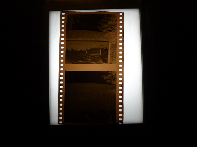

I just finished developing some 70mm Aero Plus-X. The film is used for aerial mapping, hence it is very sharp. I used the following procedure:
Presoak: 5min Water
Developer: Stand Developing: Rodinal 1:100, 60 minutes, 20 agitations for the first minute and then it stands.
Stop: 2 10sec rinses in water and then 2 minutes in water.
Fix: TF-2 ( an alkaline fixer)
Wash: 20 min
Photo-Flo: 30sec
Everything was at 20C.
When I dumped the soak water, It came out brown. With 120 film, water comes out blue/purple.
Is the brown tint normal?
Anybody have experience with this film?
Thanks!

I snipped off a piece of unexposed Aeropgraphic Plus-X #2402 and both sides of the unexposed film are a light gray color; no brown backing and yet after I soaked it for 5 minutes prior to developing, the water comes out brown?????? . I have 700 (2x350ft) of this film, so I have a vested interest in getting a handle on it. Yomorrow I'd try the HC 110 (dil 1:31) @ 5min and see what happens..... I'll take 4-5 images and develop it and see what happens.

The first is a picture of a snippet of unexposed film, front and back; the second one is the developed strip with the browish tint. Tomorrow, I'll stoke up the Omega and try some printing with these negs..... who knows what will happen.

That looks like colour film.
Is there any edge printing?

Hello, If anyone is interested, this is an update on the developing of the Aero PluS-X. Yesterday, I shot a full 15 feet at 50asa, and decided to develop using HC 110 dil H (1:64) at 9:30min. I cut off about 2 feet and will develop that tomorrow in Rodinal 1:100 stand development 60min... which led to the initial fiasco. Curious to see the results. If stained redish brown like the first roll, then the fault is with the Rodinal.???????? Will keep posted. By the way, the film is superb, great detail, no wonder it was used for mapping.
