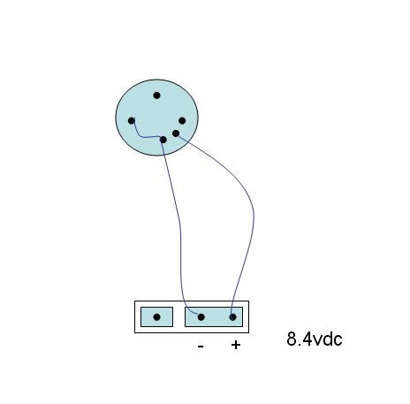

The only active pins from the Quantum Turbo to the Metz 45 are these
BTW the metal surround of the connector at the Quantum side of the cable is also connected to the negative terminal in addition to the two pins.

The only active pins from the Quantum Turbo to the Metz 45 are these...

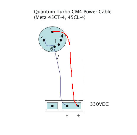

That diagram is NOT for the CM4 cable (Quantum Turbo to Metz 45CT-4, 45CL-4). The correct diagram is as below:
Note: the cable from Quantum has ground for the shield, pin 6 and pin 7. The cable from Paramount has ground for pin 7 only; pin 6 and the shield are not connected.
I just used an Ohmmeter to verify connectivity between pins on my 'CM4' cable...oddly, while the cable works when charging my 45CT4 with my Quantum Turbo (original, not later design like 2x2), I cannot confirm connectivity to any pin except the negative terminal at the flash end of the cable. I cannot successfully read a voltage between any two pins when plugged into the Quantum?!?!?!
Most likely the power supply senses when it is plugged into the flash head. To prevent shock hazard the output voltage is turned off when the cable is unplugged.
I have confirmed some connectivity exists between the unmarked terminal at the flash end of the cable, and pin 5 at the Turbo end of the cable...test with the diode setting on the VOM confirms this. Apparently it is this pin which is used to sense connection between the Turbo and the flash, causing the voltage to appear between the + and - terminals at the flash end of the cable.
