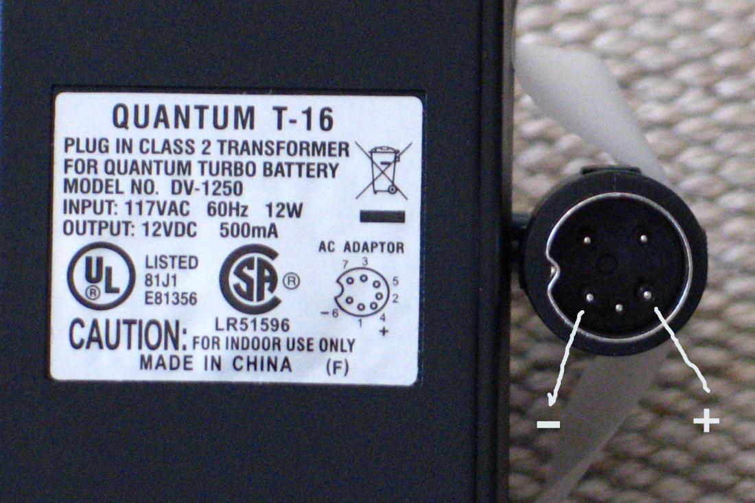

Can anyone help me to take the picture of quantum QT-40 charger (for Turbo Battery) to show the specs (voltage and current) and its pin layout? I lost my charger, and I want to build one myself.

Here is a photo of the charger and the connector plug. The voltage output is 18v with no load. I asked this same question last year on another website and got roasted. I didn't apprecate it, so I'm happy to help you out.

Many, many thanks. I really appreciate it.

Quantum pin out

So if I am going to make my own quantum QT-40 charger should I use a 12 v dc 500ma power adapter, or an 18v dc power adapter?
Also is the +/- pinout on the DIN the only ones that do anything?
