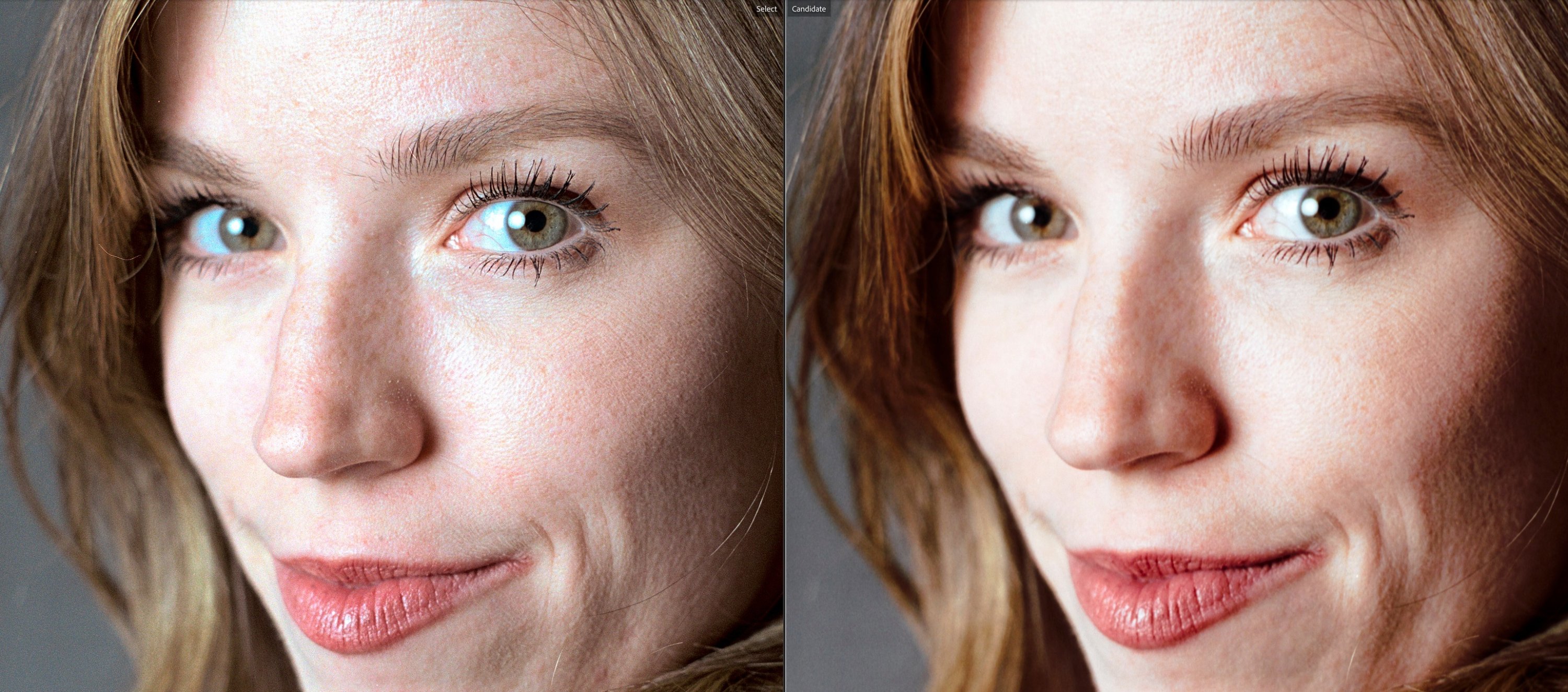

I've been researching this as well and am amazed at the level of confusion in the industry including those who don't address light source and lens issues on camera scanning and properly mounting of a negative (fluid mounted) on the V850. There are lots of flatbed comparisons (to very high-end professional machines) but little that compare a camera capture versus a V850 (as an example)? I'd love to see some actual raw scans instead of speculation and supposition.
There are plenty of comparisons on the internet out there, this is old news, nothing new here.
Yeah you can fluid mount on your flatbed etc etc.This won't compensate for its mediocre optics. V850 isn't a good deal better than the lower models, when compared to other means of scanning like scanning with a digital camera, or with a high end scanner. Sorry.
I'm providing some images just as a teaser of the TON of information out there. As an example:
Versus DSLR scanning:
Versus enlargement: V600 scan versus the scan of an optical print done through enlargmement.
In other words, the real information vs what's captured by the flatbed.

Versus high end scanner (heidelberg tango at the left, which also shows the great recovery of tones done by the Heidelberg). This test is even more revealing since the image is not pixel-peeping but small, web-size.
