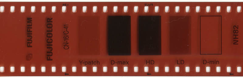

These came from a FOAF by way of our mutual friend. The FOAF now runs the photo lab at a local Wally World, and I can imagine this guy as a real stickler for quality control. He did admit that he knows of other labs which are not very meticulous in the process.
They use Fuji Frontier equipment and do a daily QA on the machines to test the chemistry and the overall results of processing.
The one on the left is a pre-exposed negative control strip. This is run through the negative processor before any customer jobs are done each day and it's then checked with a densitometer. The D-min and D-max should be obvious as to purpose. The HD and LD are high and low test points to verify the linearity of the processing. I'm not real clear on the Y-patch. He said something about this showing residual silver and that chemistry that's going bad will show up on this one.

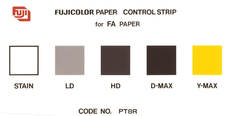

The one on the right is a paper control strip, and again it's (supposed to be) checked with a densitometer although he said that some labs just eyeball-check it. The "stain" square is supposed to be totally white and the D-max totally black, with LD and HD being certain shades of grey with no color cast. I'm not really sure about the Y-max, but it appears to be a solid yellow. (Anybody know? Class?) :smile:

Running control strips is essential to keeping any lab producing quality work. Any lab that will show you their control strip log is one you should be able to trust. You can't be a Kodak Q-Lab unless you run control strips, I think you even have to upload the results to Kodak.

The measure of the dmax blue density minus the yellow patch blue density gives a check on bleach activity. The high density minus the low density is a measure of contrast and balance. Individual control strips are only part of the story the rest is the control plots which are graphs of the measured parameters or more correctly how much difference there is between the reading at hand and the standard. The graphs were frequently reffered to as clothslines after their resemblance to the back yard drying apparatus.
In quality control one hopes for smooth but not strait lines. When the plots move beyond limits they are the first step in figuring out the corrections. The other shoe of running a good process is keeping "in spec" that is maintaining temp and specific gravity and other parameters because if a compensation is made to correct a control problem one has not solved the problem and it invariably comes back to bite. Especially in c-41 where many different products are processed in the same soup.

dmr, regarding your question on Y-max, I'm going to try to exceed the limit of your curiosity.
As analogsnob pointed out, it is a check on the bleach, where one measures the difference between the "black" patch and the yellow patch. Why? Well, the black patch has all 3 color layers heavily exposed, to make a maximum amount of cyan, magenta, and yellow dye, right? Ohterwise it wouldn't look black. So this puts the maximum strain on the bleach - maximum amounts of silver in all 3 layers have to be bleached out. So the first sign of a bleach problem should show up here.
You might think this black patch is all you need, but wait! What if the developer activity changes? Exactly! The black patch density will go up and down with developer variations. So how do you tell which one is causing the change? Now the reason for yellow patch becomes apparent. Whatever the activity of the developer, density of the yellow dye in both the black and the yellow patches will track closely together. However, when bleach begins to weaken, the first signs of failure will be seen in black. So by always comparing the two patches to each other, you have a very sensitive test for just the bleach.
Today, most places probably use a computer program to check the control strip plots, so it's not necessary to understand the guts of the process. The computer will advise on any possible problems, at least within the realm of what it can "see". I have to say that I'm a bit amused that you find it interesting; that is something of a rarity today.
