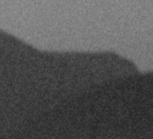

I've been dead set on PyrocatHD for the last two years, and have yet to try xtol for 35mm. I do love the wacky acutance glow for my current work with Pyrocat. Is Xtol/Mytol that much better (grain and tonality)?
Also here is a negative half developed in 510Pyro and half developed in Pyrocat. This was TMAX 3200 set to 1200ISO so it's already grainy film. 🖖

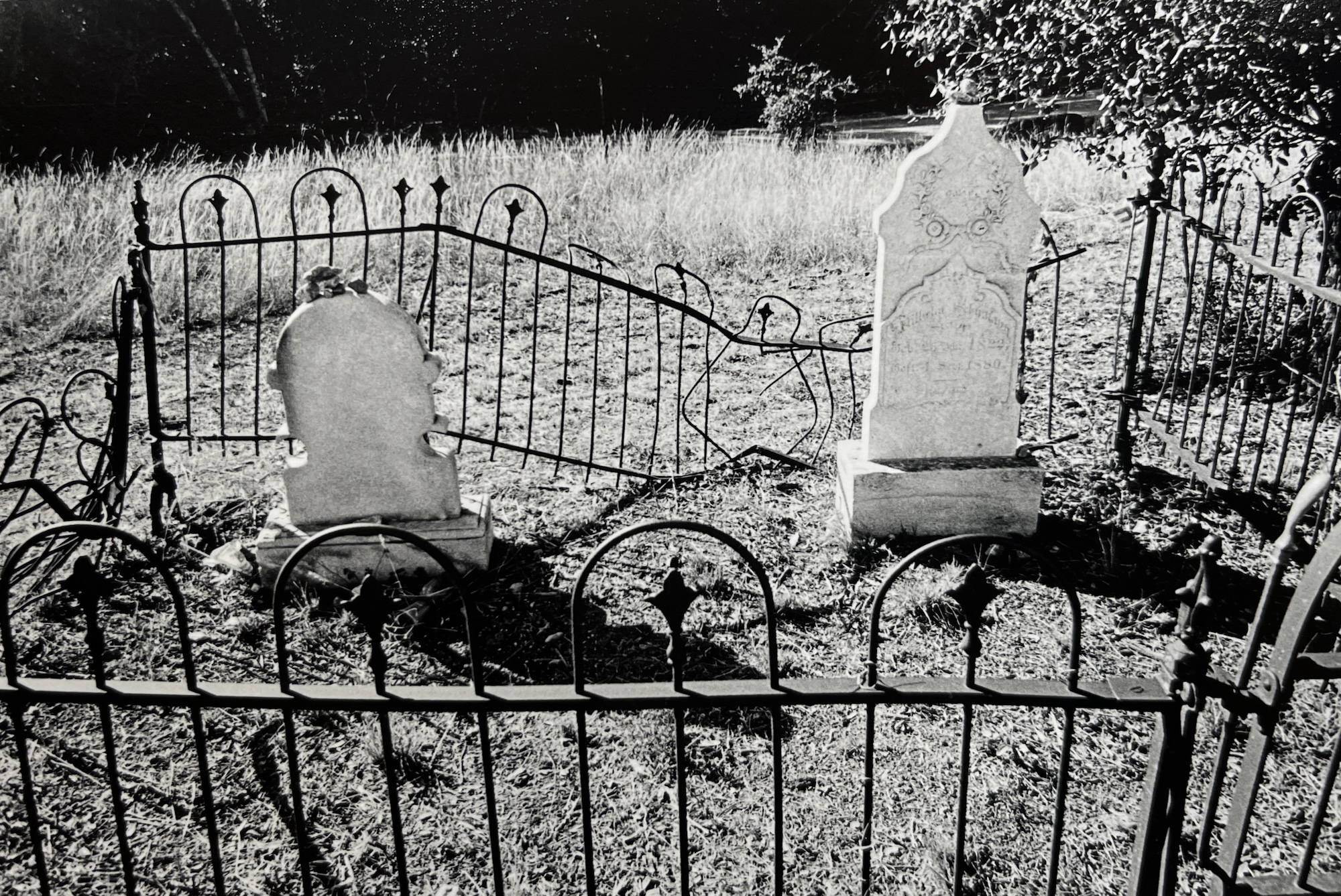

I've used Xtol, but PMK & Pyrocat have been my #1 developer for decades now. Tonality is more important to me than fine grain alone. As someone mentioned in another thread..... TMX is a bear to print with because the gain is so fine you can barely see it in the focuser. For 35mm Delta 400/TMY2 in Pyrocat are far from grainy.
Here's an iPhone photo of an 11x14" print from Tri-X (more grainy than the T films)in Pyrocat from a 35mm negative. I just don't see the grain as objectionable or an issue.
