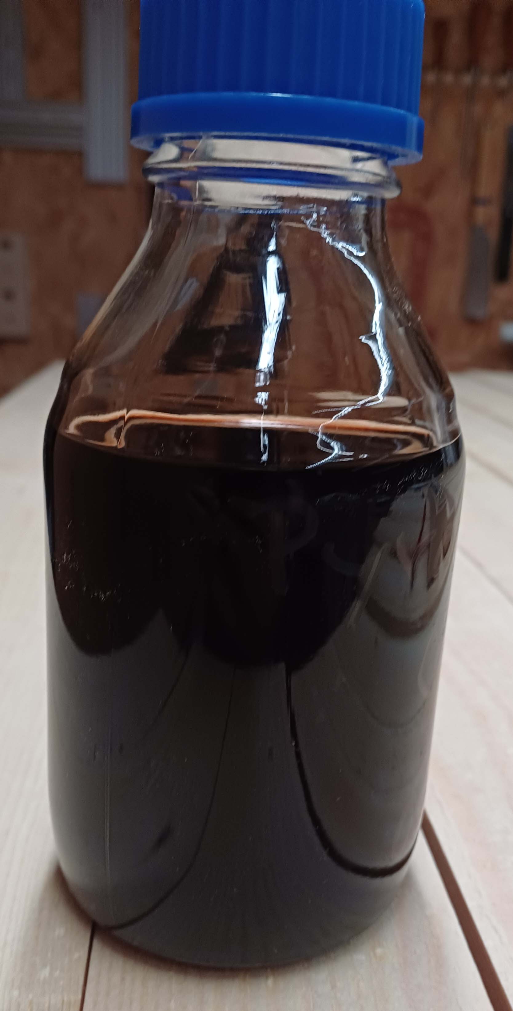

I used Propylen Glycol at 50°C. The 6.67g p-aminophenol HCL seamed to be disolved after 30 min stiring (at ca. 52°C). The result is very dark brown solution (not translucent).

If you try to make p-aminophenol by reacting paracetamol [acetaminophen, Tylenol] with sodium hydroxide it does go very dark brown very quickly due to oxidation by air [in absence of the antioxidant sodium sulfite]. In the brew pictured there seems to be some oxidation. Also as a rule, inorganic substances like chloride generally don't dissolve much in propylene glycol so look out to see if a precipitate settles out.
btw, methylaminophenol sulfate [metol] does not dissolve in glycol unless the sulfate group is first reacted with TEA.

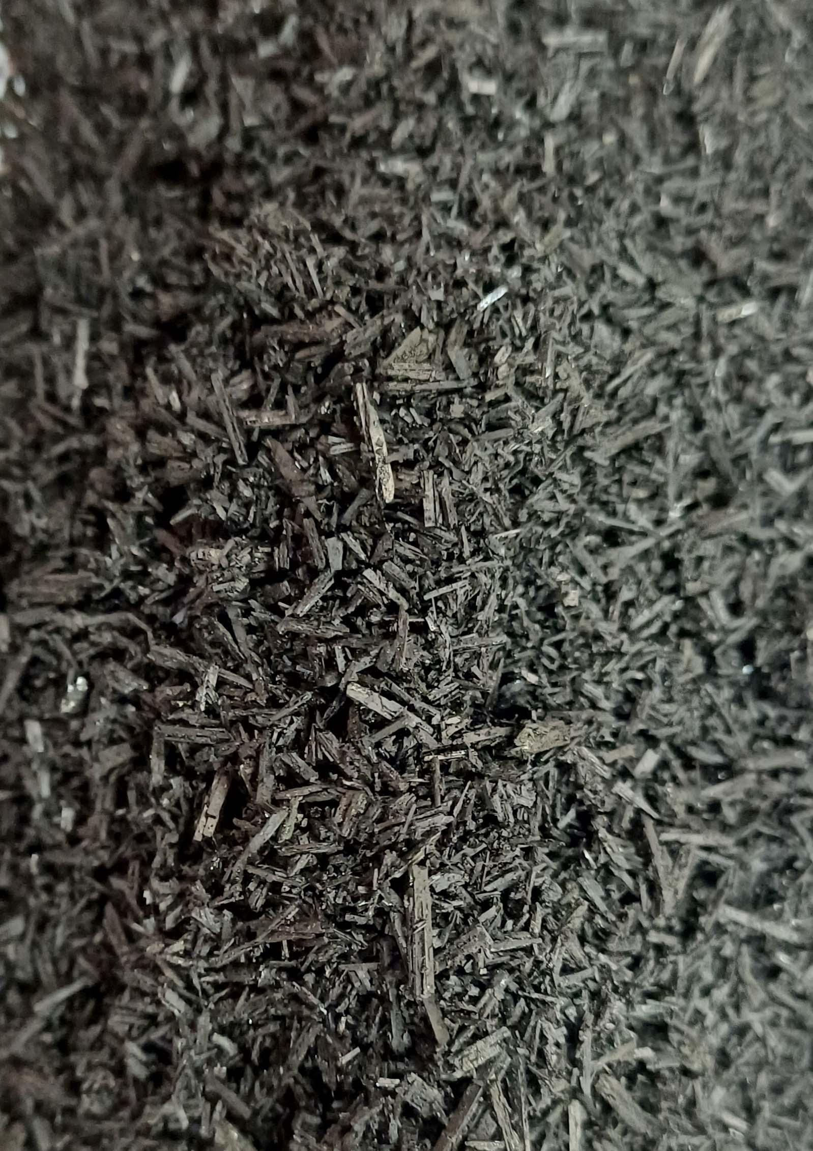

The dry p-aminophenol HCL was very dark/black crystals.

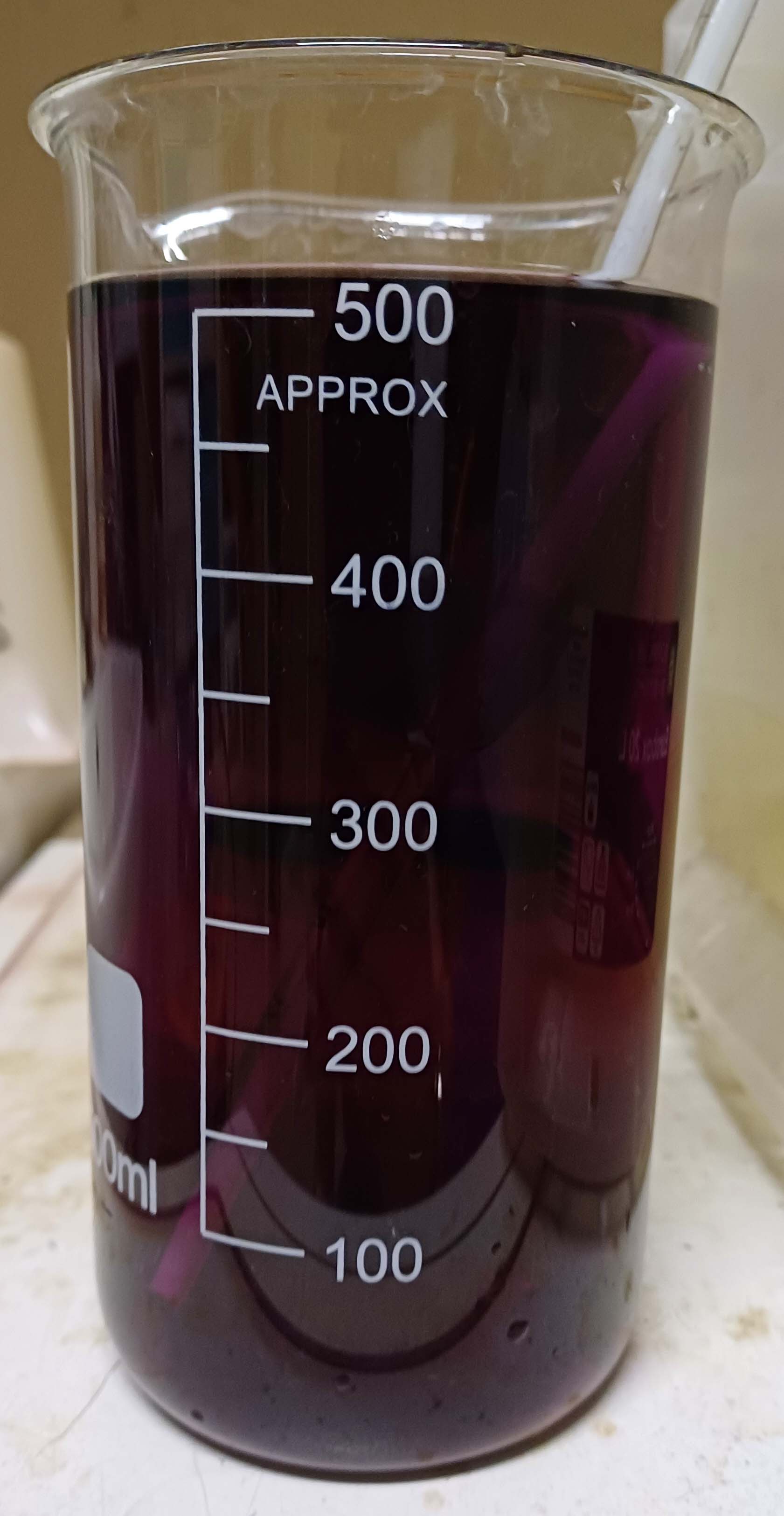

After mixing 1+1+100 I got a light pink solution that changed its colo to dark purple.

If I'm to hazard a guess, that p-aminophenol is as dead as a doornail. The developer may still work because the other components are OK. But you probably could have just as well left the p-aminophenol out.
Might be a good idea to explore another p-aminophenol free formula…
Yes, I'd say so. Or just use one of the other Pyrocat formulations that are more straightforward. There's no magic to be expected from this particular version.

The original formula turns purple exactly like that when active. I used it for years. I always looked for the purple color to be sure the developer was good and mixed properly. After use, it turns a very dark reddish purpleish ugly color.
I'd try developing some film in what you have.

I guess the aminophenol hydrochloride is gone ... the crystals should be gray instead of black?!
The batch is ca. 4 years old (from Photographers Formulary).
In another thread I found the statement from juan: "The PC version doesn't instantly turn purple - I find it turns a bit amber and slowly turns purple over several minutes time.".
Developing a stoufer wedge worked but because I'd like to use it for calibration O need a stable developer so I'm uncertain if the developer is O.K. (not only the catechin is active). Is the deep purple color a good sign?

The pure HCl salt should be white to off-white in colour. The material you have is probably still active to a degree, but the colour indicates it is likely significantly oxidised.

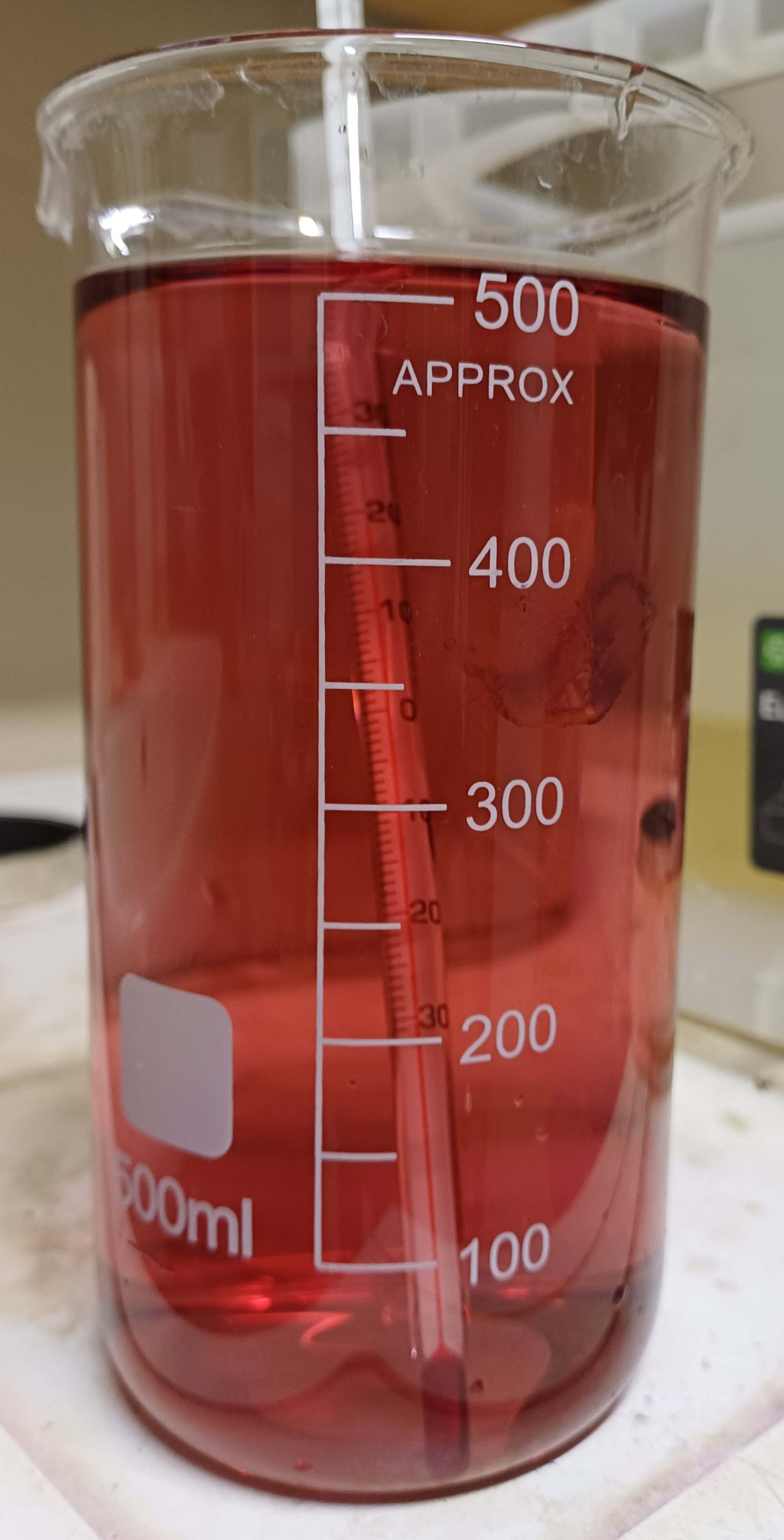

I just mixed up a batch of Pyrocat PC. I managed to find some new p-aminophenol which is a pale, slightly pink color. When mixed, the solution looks like red wine. It's still transparent, but you have shine a bright light through the bottle. I still haven't tested it out yet.

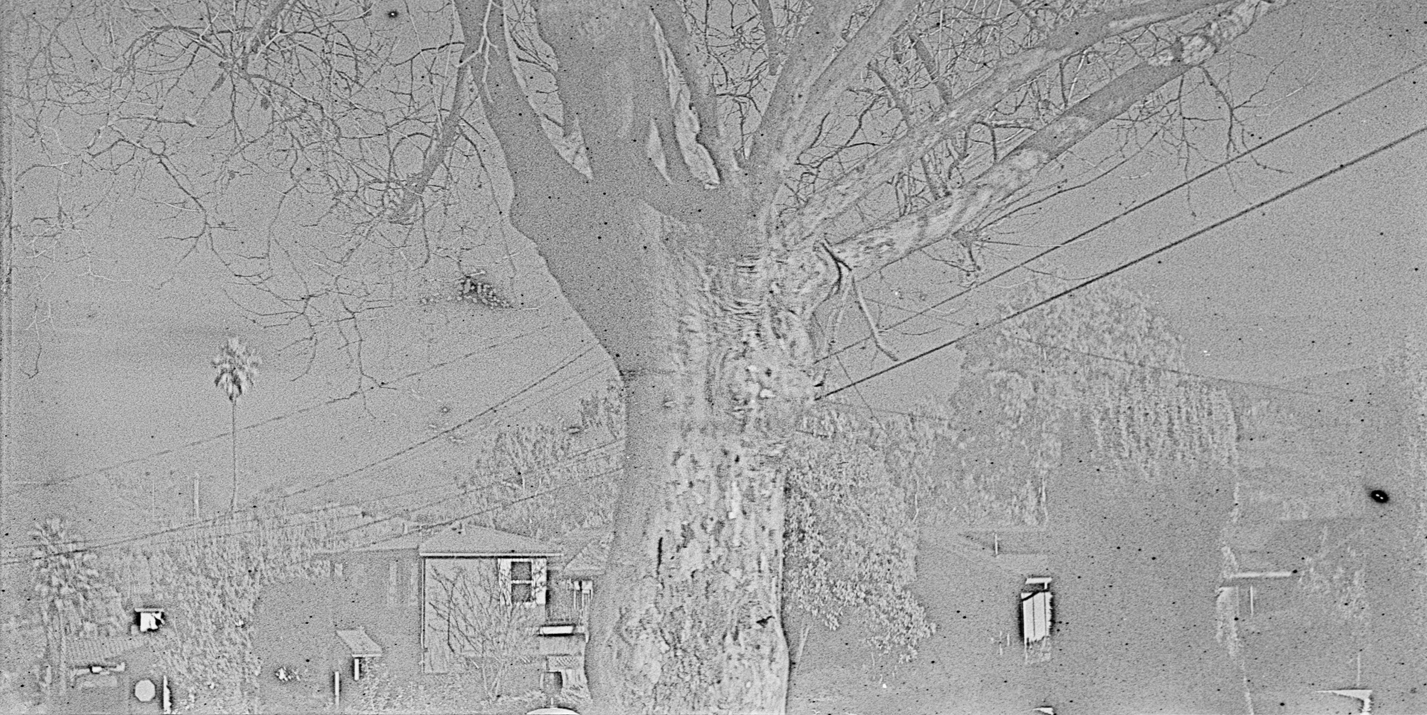

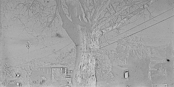

A while back I mixed up a batch using some old decomposed p-aminophenol, which was a dark purple/black color. It came out the same sort of red color, except it was almost totally opaque. I used it for around 6 months, and I initially got some pretty good results. Except in a few instances with 120 film and minimal agitation I had some serious mottling problems. Way more than I had seen before with any pyro developer.
When I first started using it, the working solution would gradually turn purple over the course of maybe 4 minutes. Towards the end, it would turn fully purple in like 30 seconds. This is when I started having some serious failures. If it turns purple that quickly, it's probably bad news.
Here's the last thing I developed with it, when it really showed how truly bad it had gone:

Might be unintentional but I really like the result!
