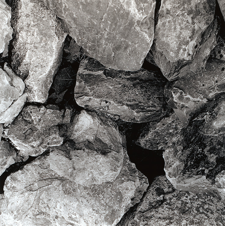

Really nice photo - displays everything I'm hoping to get from trying out staining/tanning developers with that local contrast and acutance.
I think a big part of the reason that I'm so interested in trying this out (and also why I started experimenting with BTTB recently) is because of the theory behind compensating high-acutance developers. I shoot primarily nature subjects in overcast light or open shade. It's just what mostly ends up in front of my lens. So the ability to simultaneously increase local contrast in scenes with low inherent contrast, and help tame brighter highlight areas when I (for example) include a sky, all at the same time as introducing edge effects... sounds pretty ideal for about 90% of the photography I do on roll film.
You may find my notes helpful:
Just be careful, it easy to overdo this. Even though Pyrocat-HD is a semi-compensating developer, and even if you highly dilute it, it's easy to blow out the highlights while you're busy expanding the mid tones using EMA or (semi) stand.
You also have to watch, because the higher dilutions can yield very acute negatives that give you pronounced grain in small formats like 35mm.
For MF and larger, it's all good. Note that Pyrocat-HD is only somewhat compensating. So if you want to develop for a long time to expand mid tones but want strong compensation, I find that D-23 1+9 with 0.5g/l of sodium hydroxide for 60 min with an initial 2min agitation and one midpoint 15 sec agitation does that trick nicely. It will give you razor sharp negs at the expense of grain, which is why I don't do it with 35mm.
Anyway, it's fun to play with, just use good lab technique, gloves, eye protection, and an apron. The various components of these developers and things like sodium hydroxide are nasty if you get them on your skin or in your eye.

(Keep in mind that the picture above is from a 6x6 Hasselblad negative so YMMV.)
