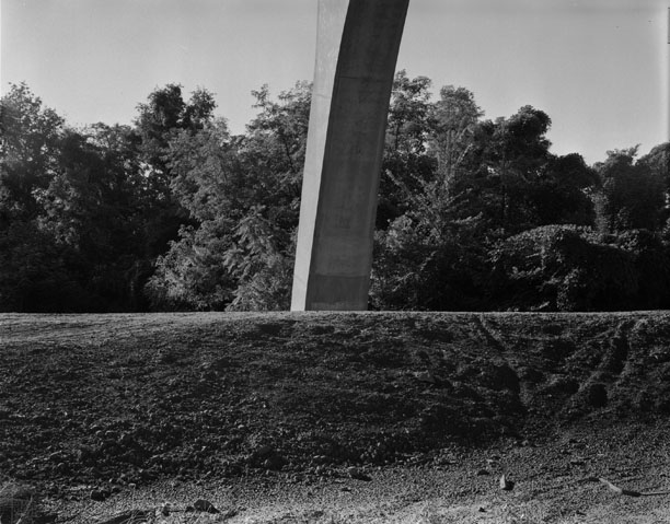

I have been working up to a time/temp combination with Pyrocat HD and 4x5 FP4 for stand/semi-stand. I have arrived at a good contrast level (for my Aristo V54, Dupont MG filters, and Forte Fiber VC paper.
ASA 50 for the film (final test negs shot with incident readings to eliminate any "previsualization" errors.
I use hangers (someone on a thread once said hangers are ideal for stand development). The tanks hold about 2400ml, the reason for the measurement. Agitation is alternate diagonal draining off of each corner, continuous, being careful not to be too turbulent about it, but to keep things moving (learned about surge marks many years ago in the Army).
73F, 15:10:2400 with distilled water (very close to 1.5:1:250).
2 minutes presoak (mostly continuous agitation, tapping off airbells now and then), into the developer - 1.75 minutes initial continuous agitation, 30minutes development, agitation for 15 sec (4 lift and drain, 2 on each side) at the 10 minute marks. So, they get 2 agitations, one at 10 and one at 20 minutes.
When I was doing individual sheets to establish time/temp, I didn't see any problems, but what you can see in the attached images came from the last development session, these 2 negs are from a group of 4 films done together.
The tanks are good size, have light tight lids (the ends of the hangers sit on a "shelf", an inch or so below the top of the tank), and are great for doing this, and hold 8 hangers. The top surface of the developer is a good 1/2" or so above the tops of the holding bales in the hangers.
You can see that the offending areas are related to the hangers, surge of some kind, I guess.
Image one is along the left side, and a dark vertical edge running down the large butress.

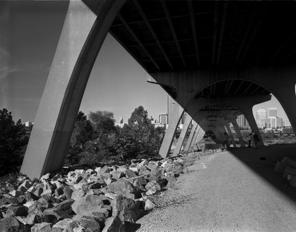

Image 2 is along the right edge, with a dark area somewhat along the top on the right side (hard to see in the attachment).
Both hangers were positioned the same, in parallel, so the problems are opposing, in a sense.
I am disapointed at getting so close and have this problem. The quality of acutance is just what I want, so I'm inclined not to agitate more often...but will if I have to. Sorry for the long post, but I wanted to be thorough.
Any suggestions?

I can sympathize with your problem, but unfortunately don't have too much to suggest. I too tried Pyrocat /semi-stand with FP-4 on hangers and could not get it to work consistently. I had problems that looked much like yours and assumed it was due to improper agitation, but could not figure out what to do . I finally gave up on hangers and now use a Slosher type cradle in a tray with great success. I'm very interested in what other people have to say about this because it would be nice to be able to process more than 6 sheets at a time.

George, from reading Steve's comments about stand development, in general the problem comes from initial agitatation of the film. It seems the fluid is reacting to the edge of the film hanger and creating greater activity along this edge, due to the flow characteristics. I also use tubes for this type of development and don't have problems. It is just a single sheet at a time per tube, but agitation by roll, pitch and yaw seems to be just the ticket for me. While more labor intensive, it seems to work pretty well because there aren't areas in the tube to create cavitation or swirl marks due to the hard edges. The slosher system works well enough, but I prefer working with the lights on for longer development times. tim

I have used pyrocat for quite a while with hangers. I think you may be over agitating.
Longer pre soak and very slow lifting and tilting of the hangers, it might take as much as 10 seconds or more for one hanger, and just once or twice in the beginning. If you are having more than one hanger in the tank, merely moving one gives the others some agitation.
I use 1.5, 1.5 to 100 for semi stand, 30 minutes. Slight lifting and tilting of the hangers once every 10 minutes, no more.
