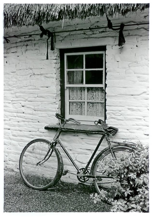

bogeyes
May 2, 2004
291
uk
Tmax 100 pyrocat hd glycol
Shot with Nikon f601m 35mm lens TMax 100 @ EI 80 Pyrocat HD Dev. 15 mins 20c small paterson tank 1:1:100 3ml A:3ml B : 300ml water Pre-soak 5mins Agitated first 90 secs then 2 inversions every 3mins. This is my first attempt with Tmax/pyrocat. The print has not been dodged or burned, printed on Ilford multigrade vc glossy at grade 21/2. I will print it again after I have stuck it on my fridge door for a couple of weeks and had a good look at it.
Dave Krueger
Dave Krueger
Jul 30, 2006
714
Huntsville, Alabama
Hmmm... I wonder how important the presoak is. I could certainly try it and see if that makes a difference. There's something about my particular porcess that affects TMAX 100 and does not appreciably affect the TMAX 400 or Pan F+.
Nice visual aid, by the way. :smile:
-Dave
