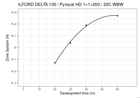

Does anyone have experience using Pyrocat HD for N+1 or N-1 development? Specifically I am using Ilford Ortho Plus at 14:30 according to massive Dev with good results. But want to know if I should change from a 1:1:100 dilution for either direction of development and if the 30% reduction in time is a good rule of thumb.

There is unlikely to be a simple linear relationship between N-development and development time, so making generalizations about specific increment is difficult. The range N-1 to N+1 is more realistically achieved; further extensions in either direction require additional testing to figure out a more precise increment.
Having said that, I think that a 30% increase/reduction from your N-development time should be a good place to start, without changing the dilution. To illustrate the point, here's a plot of Delta 100 developed in Pyrocat HD 1+1+200, using semi-stand development. You can use it as a very general guidepost, but the actual time will be yours to figure out :smile:. By the way, this particular plot uses the calculations recommended in the book Way Beyond Monochrome (fig. 10, p. 138). Other sources calculate N-numbers slightly differently, so keep that in mind. My semi-stand routine is as follows: start with a two-minute continuous agitation, then let the film stand for half the development time, then make 2-3 inversions, and let it stand for the remainder of the time. Other agitation schemes would probably produce a somehwat different curve.
