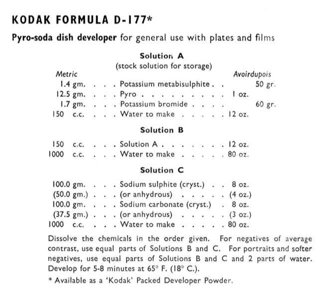

There were non staining Pyrogallol developers made and sold commercially I have the formulae somewhere, and both Ilford and Kodak used Pyrogallol in MQ commercial D&P developers as an oxygen scavenger.
Kodak D177 is a Pyro-Soda dish developer with Sulphite that Kodak Ltd sold as a powder packaged developer, it has 50g Sodium Sulphite (anhyd) to 12.5g Pyrogallol. I think the idea is just enough Sulphite to prevent the stain but not enough to prevent the tanning and edge effects. I have a 1939 Kodak Ltd Professional catalogue that should list it, it's in my darkroom (at the end of my garden) I'll look and see tomorrow.
D177 was one of a series of Kodak Ltd developers not made or sold by Eastman Kodak.

I checked the Kodak Catalogue which was 1940 not 39 but there was no mention of D177 (which is in the Wartime Kodak Formulary annd post War Kodak Chemicals and Formulae - both published by Kodak Ltd). Instead Kodak were selling D190 another powder packaged Pyro-Soda developer.
Ian

Found this on the web.
Raghu Kuvempunagar
Raghu Kuvempunagar
Jul 28, 2016
3,091
India
I have the actual books :D
Ian
I don’t doubt that. :smile:
D177 seems to be using a lot more Catechol per ml of working solution than modern staining developers. Is this how it can produce substantial tanning effect while not staining in the presence of sulfite?

Pyrogallol is referred to as Pyro not Pyrocatechin by Kodak. Just spotted you're correction
Part A is diluted 150ml to 1 litre to make Part B so it's quite dilute like modern staining developers. As it's very dilute it'll be slower working so won't be anything like as grainy as conventional Pyro developers which are energetic
