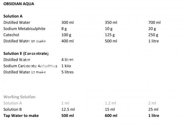

I use OBSIDAN AQUA all the time unless I'm using 510-PYRO
Here's how I make up my solution A and solution B. http://freepdfhosting.com/aa330a94ce.pdf
You need to know what formulation has been used for YOUR solution A and solution B.
I use an agitation regime that just about qualifies as semi-stand... The amazing thing about this developer is that you use the same time for all black and white, silver based, films of all speeds. I even develop 25 ISO films in the same tank with 400 ISO films. I have not used FOMAPAN 400 though but have used FOMAPAN 100 and 200 with satisfactory results. (My go-to 400 ISO film is ILFORD HP5 Plus.)

Your friends suggestion to use 1 + 5 + 500 points to the Potassium Carbonate variant of OA. The Sodium variant would require 12.5ml of B since this is not as concentrated as the Potassium solution.
Try with 22 degree C.
I struggled with OA for a long time which Regular Rod can attest to. I am sure he pulled a few hair out trying to help. but, I have now found a couple of film that looks good in OA. Fuji Acros and Fomapan 200 both exposed at half box speed.
One important factor to consider is your enlarger type, If you are using a condenser enlarger I would cut a couple of minutes of the time Regular Rod suggest.

I'd say that was likely to be wrong. The right thing to do if the dilution is 1A + 5B: 500 is to take say 300ml of water, add 1 ml of A and then add 5ml of B then add water TO MAKE 500ml. You should have a total of 500ml NOT 500ml plus the quantity of A and the quantity of B...
Time for me would be 12 minutes at 20 Celsius BUT with constant, smooth, gentle agitation for first full minute then 10 seconds smooth, gentle agitation at 2 minute intervals until 1 minute to go and then pour out the developer at the full 12 minutes. IT IS BEST to pre-soak FOMAPAN for a full 5 minutes with smooth, gentle agitation every 30 seconds, I pour out and then rinse once more for a few seconds before pouring in the developer. NO STREAKS OR BUBBLES this way...

You folks all realize you've gotten the use of Jay DeFehr's Obsidian Aqua all mixed up? No wonder we're seeing bad/inconsistent results..! I am deliberately not calling the first OA (stock) solution "A" and the second solution "B" because it seems to be causing all the confusion. This ain't your father's ol' pyro, folks. The second solution is the diluent for the stock--you do not add water to make a working solution out of the first two mixtures! You just dilute the OA stock with the second solution; it needs the alkaline environment, but is extremely concentrated otherwise. To clarify:
1. Mix up the first OA (stock) solution as described, taking into account the info in the next step.
2. Mix up the second (diluent) solution; if you used sodium metabisulfite in the stock, you should use sodium carbonate in the second (diluent) solution; if potassium metabisulfite was used in the stock, potassium carbonate should be used in the diluent solution.
3. Take 1mL of the OA stock (the stuff with the catechol and metabisulfite) and add it to 500mL of the second solution, or diluent. That's it! You do NOT want to dilute further: this is not an ABC-type of sauce!

"My" solution B is made up in a more concentrated form than the original recipe because it uses distilled water and is inconvenient to store such a large volume of sodium carbonate solution in the diluent strength. I took Jay's advice and made up the more concentrated solution of the sodium carbonate so that it was convenient to store and minimised the volume of distilled water needed to make up the solution. So... if anyone is using the recipe I use please DO continue to use it as solution A and B and add tap water to make up the working solution.
RR

Not to worry: Rod's using a different road to get to the same destination by concentrating the B more as an activator, then diluting the two mixed, concentrated, solutions to working strength.
