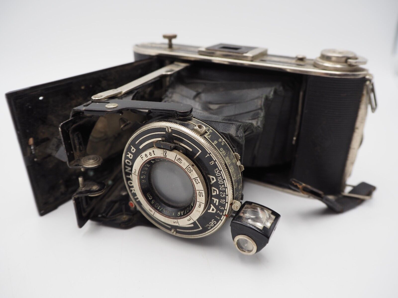

The idea of sacrificing a far superior Rolleiflex to fix an Agfa folder is very questionable. What are your goals? Are you trying to restore the Agfa? Are you building a custom medium format camera using the Agfa body?

Sometimes you get broken rolleiflexes for far less. Was just thinking, all that counts is the lens and the right focal distance :smile:
Also I wouldn‘t sacrifice a super isolette, thats a beautiful camera
Just wait till you find a suitable donor camera. It took me several years to find this totally wrecked Agfa Billy that I got for A$8.
I only needed the shutter release button and the brilliant finder that were missing from my Agfa Billy, my most used folding camera.
