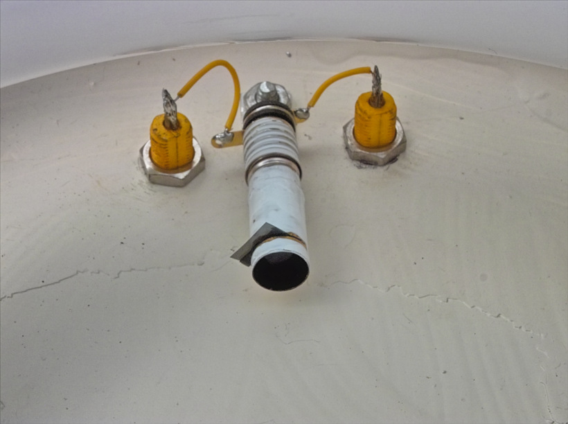

After getting a few uncontrolled variations in some recent prints, I decided to add a light sensor to my Omegalite-D.
Took a few simple supplies: A couple banana plug sockets, a miniature light socket and a CdS cell.
I smashed a small light bulb and soldered the CdS cell to the filiment leads.
Then I soldered a small tube of brass to the base to protect the cell, cut a slot in the brass tube where I can insert ND filters, painted the inside black and the outside white.

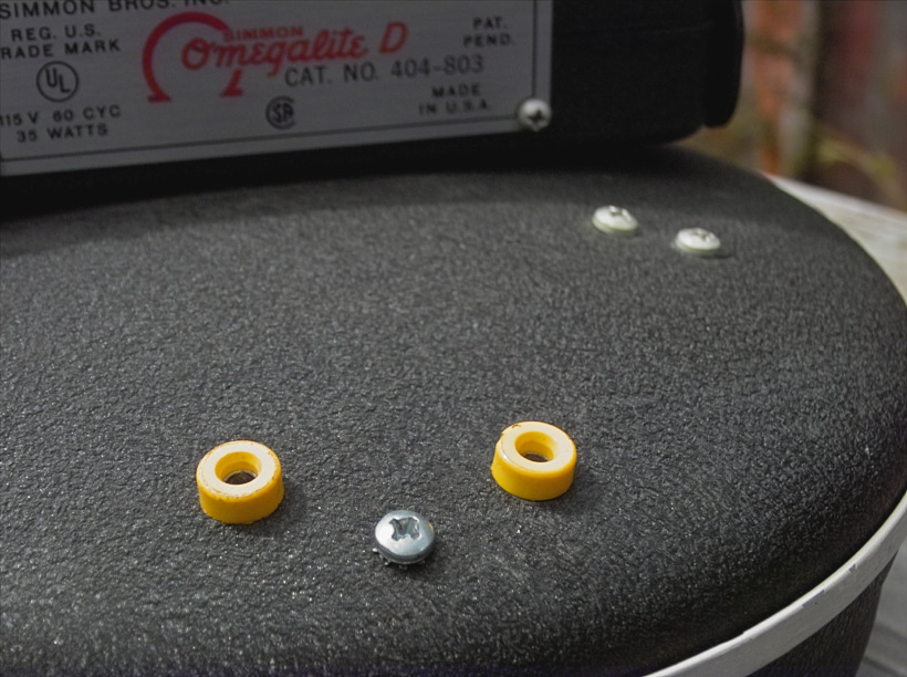

Installing only required some drilling in the upper shell. Pretty basic work.
Satisfied with the work but wished I had pointed the sensor to a better "integrated" portion of the dome. As it is I have it pointing towards the ends of the bulb, where there would tend to be more variation than average.
I had done a breadboarded metronome, but I get either no tiks or two tiks per second nothing much else. So if I am going to make that work I'll need some kind of "amplifier" circuit to magnify the resistance changes.
For now, I am just going to use an ohmmeter to monitor the resistance of the CdS immediately prior to test printing and final prints.

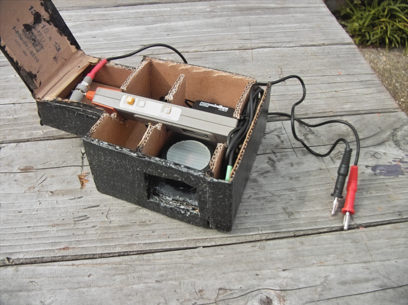

I picked up this project after being outbid on the Zone VI Compensating Metronome couple weeks ago. I might pick up the sensor linked in this thread, an advantage of making it modular... I would just have to solder it to a light bulb base.
Here's the project... A Jobo minilux and a Beckman Circuitmate DM73 in a cardboard box...
As installed...
The light from the circular fluorescent bulb is fairly steady once "warmed up" but the housing never really gets "hot" (the bulb stays cooler than I imagine the Aristo grids).
The resistance is about 6.0 Kohms cold and about 4.5 Kohms warm. Light at the baseboard (27" height 135mm f/5.6) is near EV 1.0 when warm and near 0.5 when cold. When warm it seems to stay in a narrow range from EV 0.9 to 1.2 so it really isn't that bad. This might be all I need to keep tabs on print exposures.

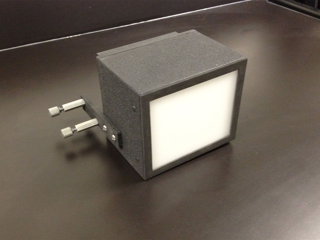

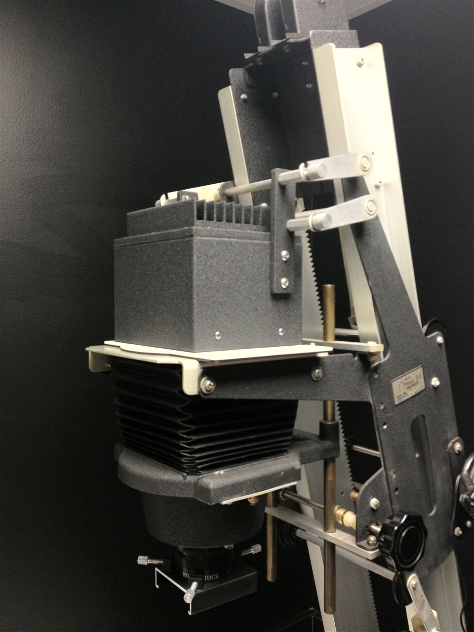

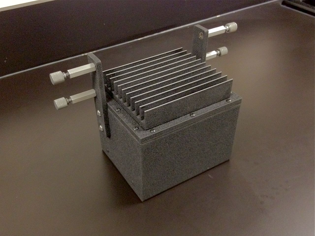

Very clever work. Another option would be to go with LED's which are more stable than fluorescents, run cooler, last longer and require less energy to run. Toward this end I have nearly finished an LED diffusion head for the Omega D series enlargers which I plan to offer for sale soon at a reasonable price. It works fairly well now but I would like to bump up the light output a bit using the new Cree XM-L series of LED's. Also I need to tweak the LED placement a little to get absolutely uniform brightness but otherwise it is done. Attached are photos of what it will look like. Power consumption is about 25 Watts from an external power brick and light output will be about 1000 lumens.
Nice work!
