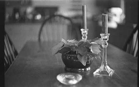

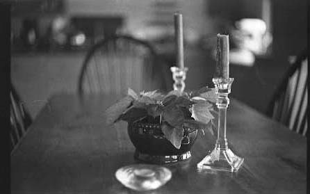

caffenol-c and HP5
Here's some examples of HP-5 rated at 200, 400, and 800 and developed in Caffenol-c for 15 minutes. Low resolution scans, flatbed, no post processing.
exposed as if ASA 200
exposed as if ASA 400
