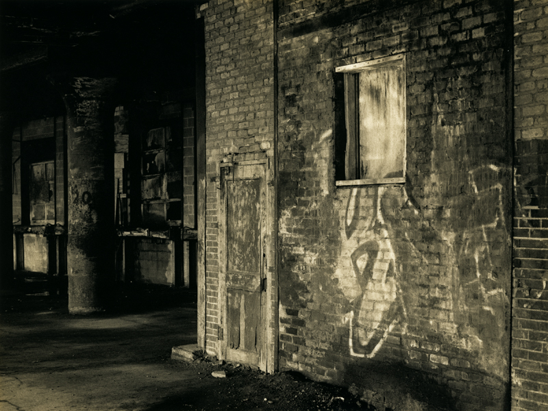

I would have no problems shooting TMax 400 @ 800 and get results that are very acceptable, even from a highly technical standpoint. Foma 400 is completely different in terms of film speed, and my experience thus far with four different developers is that its true speed is somewhere between EI 200 and 250.
The best success I've ever had with it was in 35mm using Edwal 12 developer. Believe it or not, I used the film at EI 160, almost one and a half stop below box speed, and while the resulting prints are something that I'm very happy with I still feel like I'm not getting full shadow detail.
Example attached. Slightly cropped 35mm neg, printed on Fomabrom 112 in Ethol LPD, toned in Kodak Sepia II and Rapid Selenium toner.
I guess I'm showing this because the Foma 400 film just isn't a film that I've been able to get 400 out of, under any circumstance.
