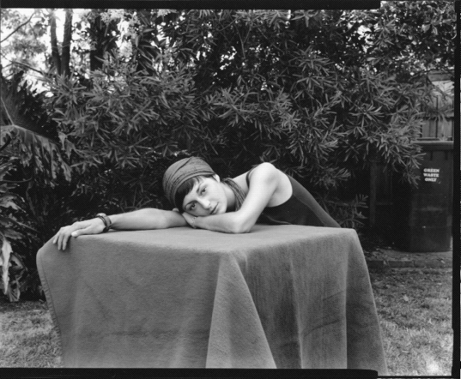

I have used FP4+ a fair amount in the past in 135 format, currently I am using it in 4x5” sheet film.
You can quite easily get a good 200 or 250 exposed negative suitable for printing, going that little bit further to 320 or 400 will depend upon your subject and the weather conditions.
If the conditions are bright sunlight and your subject is a portrait, then I would suggest you use another film for that particular shoot under those conditions. I generally have found I lose highlights under those conditions and burning in for a nice print is a bit hit and miss, not to mention tedious.
If however, the conditions are cloudy bright (or even cloudy dark) and a portrait, then pushing FP4+ a stop, is probably a very good thing as your portraits should have a sparkle to them. Usually fairly straight printing to boot.
I use D76 1+1 for two reasons. One, I compared it to Microphen developed negatives, there was a slight difference, but I wasn’t ever sure it was just the different developer. Two, I mix up D76 from raw chemicals ensuring I always have fresh developer, and, as a bonus, it is generally the cheapest way to obtain any developer.
I have pushed FP4+ higher, including to 1000 ASA, it is doable and sometimes terrific at those speeds. But to me, there is always a diminishing rate of return the higher you go. I almost always, when I do push FP4+, only push it to 250.
I f you go here, then visit my gallery to see the full frame negative and read the explanations, you will see an FP4+ negative exposed at 200 ASA to give me a kick and some exposure speed.
You will see the difference between the full frame straight contact and the cropped and enlarged and manipulated print. Note the possibility of obtaining a nice tonal range in flat lighting, by pushing the film almost a stop.
This is the straight full frame unmanipulated negative.
Mick.

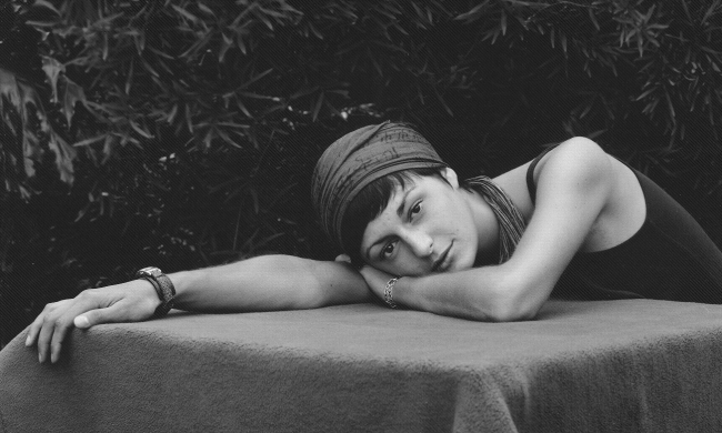

LAG, I don't normally do this, but will this time. Below are two attachments, one is the full contact print of the sheet of film, the other is cropped and printed as I wished.
For what it is worth, this is FP4+ that was exposed at 200 ASA. I would have to check my developing notes, or film exposing notes to be sure, but I almost always expose FP4+ at either 100 ASA or 200 ASA. The reason for pushing it to 200 ASA was to give the film highlights a kick (make them a bit brighter) which would allow me to print as I wish to print.
The aim was to have the brightest point of the image on her face, which it is. Basically the brightest point of the print is the bridge of her nose and nearby area. I allowed her thumbnail to also be bright but with detail, which is quite obvious on the actual print. Having her thumbnail also quite bright, seemed to be the correct balance.
I shot and printed this on an extremely hot day on Christmas Eve 2007, spending Christmas day in the darkroom making prints so that the young lass in the picture could take some prints home to Germany; she was leaving a couple of days after the session.

Please note on the contact print, the blandness of the sky, which was cloudy and the reason for the push processing decision; the contact is a straight print.
Quote from the gallery notes:
I did this on Christmas eve and spent Christmas day in the darkroom developing the film and contact sheets. Today (26th) I spent some time doing an 8x10 then I decided to do a 12x16 print, something I rarely do, usually I wait and contemplate.
Suzanne, you are correct the skin tones are glowing in the print, the blacks are far better than on the scan. I had a couple of variations to scan in the 8x10 prints, I chose the print that scanned the skin tones that best matched the 12x16 manipulated print.
I held the right eye and cheek for a 1/4 of a stop, the right hand is burnt in 1/4 of a stop, the right thumbnail is burnt in another 1/4 of a stop on top of the hand burning. This was really difficult to do on the 8x10.
The surrounding background and the vertical edges of the dark green blanket are burnt in 3/8 of a stop. The rest of the print is base exposure.
It is heavily cropped as I wished to use the 150 lens without much bellows draw, thereby eliminating the need to use an even lower shutter speed. I wished to use f22 for depth of field, life is always a trade-off.
Unquote:
This is the cropped finished print.
Mick.
