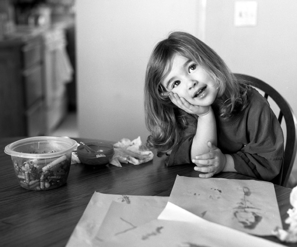

In medium/large format, I almost always rate HP5 at 800. I use HC-110 and find the tonal scale very smooth and the grain--well in 4x5 its not even there. In 6x4.5 just enough to remind you its there. HP5 is very forgiving and HC-110 is dead simple and for me wuite predictable. The portrait below is an example of why I like the combination.

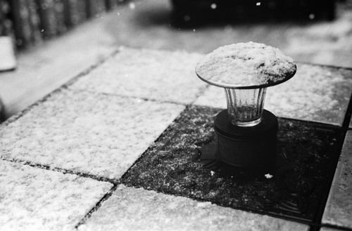

This was made with HP5+ pushed to 3200 and developed in Rodinal:
So I'd say go for it!
