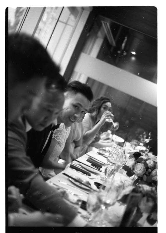

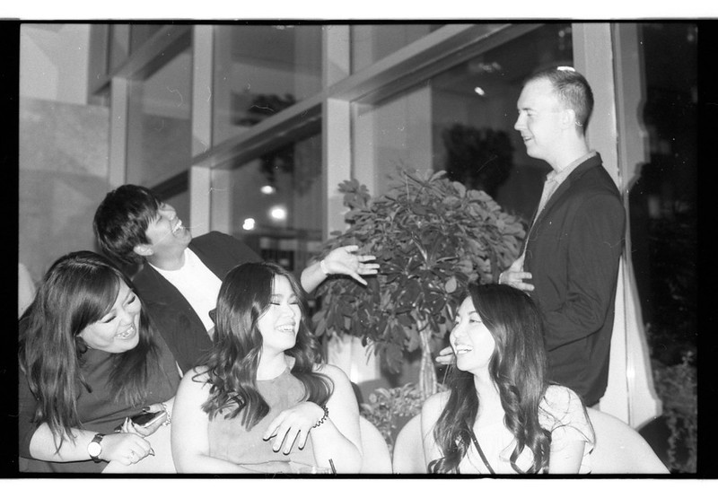

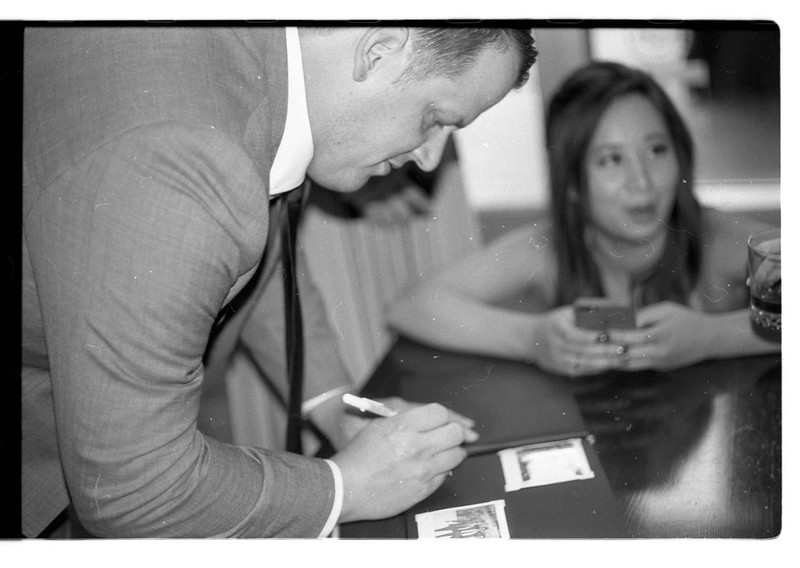

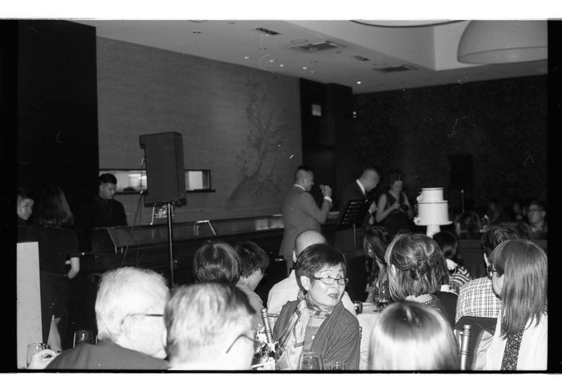

I tried to stick to developers that I already have, ended up choosing D76 full strength as it is better for pushing undiluted. Except for the shots which were horribly underexposed I could not be happier. Classic FP4 look. Beautiful negatives. Some quick auto scans:
FP4_036 by Aaron, on Flickr
FP4_003 by Aaron, on Flickr
FP4_021 by Aaron, on Flickr
FP4_024 by Aaron, on Flickr
