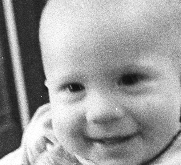

Lately I've been pushing Kentmere 400 to 1600 in arista liquid developer (stock dilution 16 minutes) and got the results I expected. It's pretty grainy, but even when I gave the film EI 400 in the stock developer it was pretty grainy. It has more contrast, and of course, loss of shadow detail. The tight crop attached was scanned at 400ppi. More examples are at: http://misterkickass.blogspot.com/2010/12/turkey-days.html

Based on mrred's comments I can expect better shadows in my film if I minimally agitate and extend development times, perhaps using 1:1 dilution will help as well.
I had tried 1:1 with this film developer combo at 22minutes and highlights weren't dense enough. I only have a dozen rolls of this film left and I'm about to switch to xtol as my developer of choice, so I'm really looking for more general guidelines. It sounds like the answer is yes, stand developing helps when pushing.
