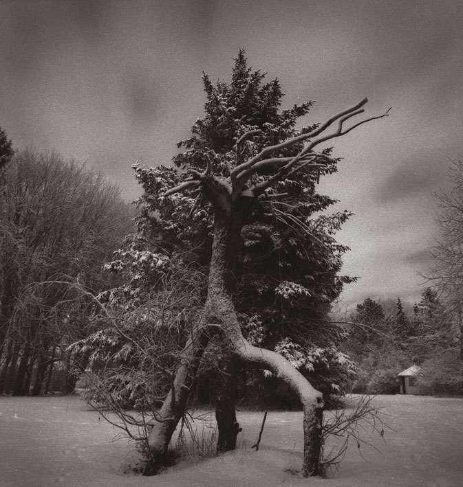

Delta 3200 is one of my favourite films - I rarely expose under 12.500 iso..
a couple of results:

Gandolfi, those are some nice examples! Could you tell us more about the above shots (or about the way you work with Delta 3200 in general)?
Very nice shots indeed. Please throw some more light on the developer and EI.

Very nice results Gandolfi, thanks for sharing.

Delta fan(s) are still waiting for you answer Mr. gandolfi, regarding the developer and EI of those pictures you have posted.

Gandolfi, subscribe me, too, to the list of folks who want to learn which soup you use.
