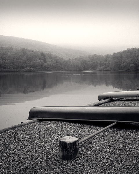

I've had luck pushing Across to EI 200 and developing in Xtol 1:1 for 14 minutes. This was in overcast lighting and is the most I would consider pushing the film without extreme developing techniques. I couldn't imagine the shadow detail i would lose in contrasty lighting. But for flat lighting it was great! Here's an example...
