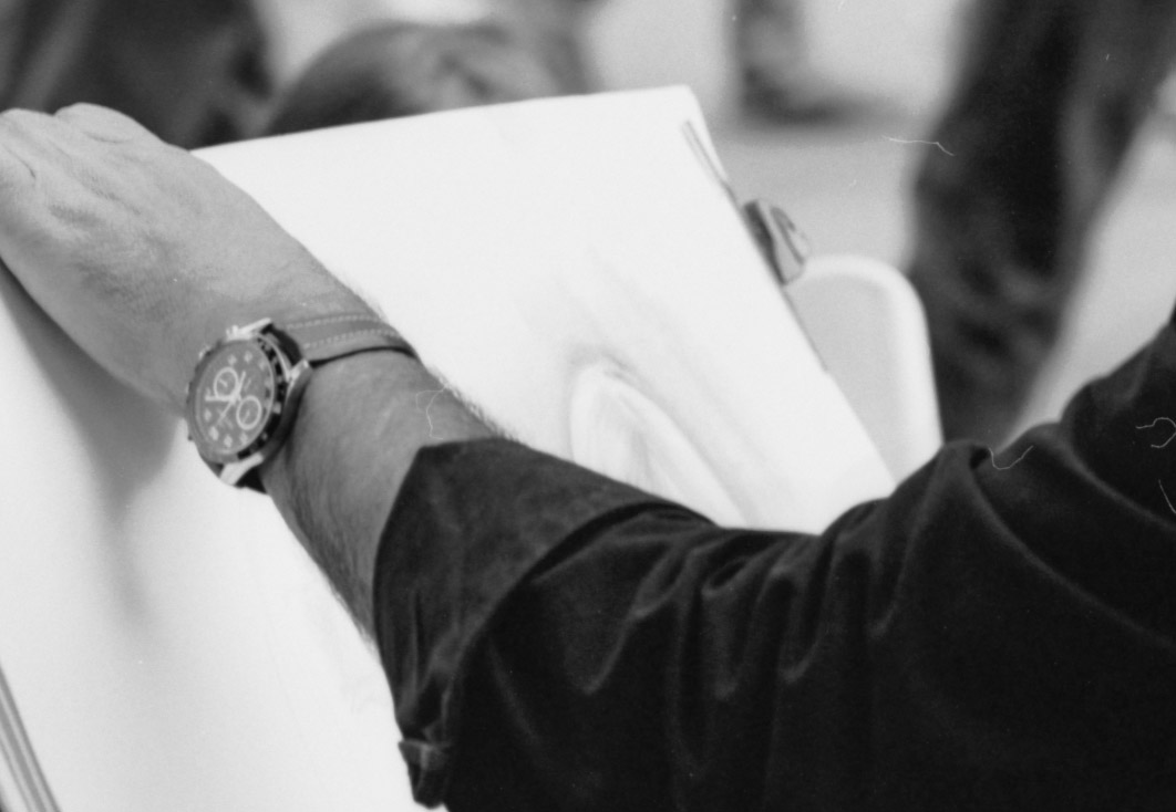

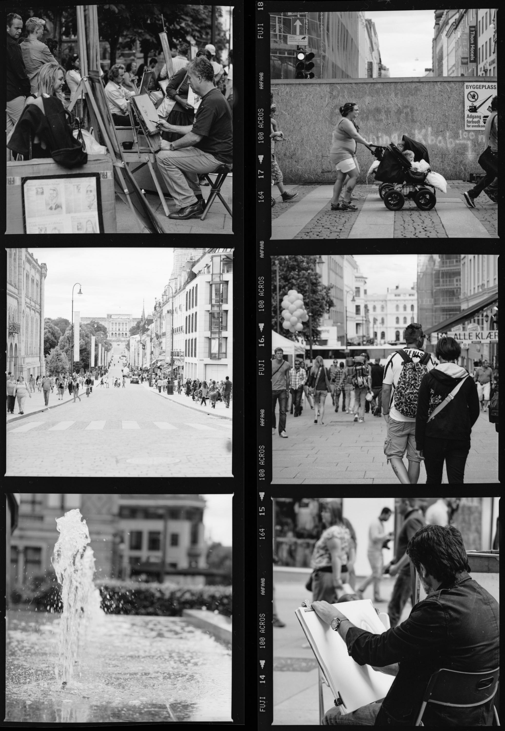

I use HC-110 Dilution H for 18-20 minutes or so (or B at 7-10 minutes), 200 absolutely no problem, 400 not really a problem either (a bit higher contrast off course, noise in 120 is just about non-existent).
Attached a not very explainable example of Acros shot at EI 400. (click the thumbnail-film-strip picture a few times to get to the 3000*3000 pixel browser view)
These are scans, black point adjusted to where I normally place them when making proof-prints in the dark-room, where I see a hint of the base..

When posting examples I think it makes sense to describe the rest of the system, not just the film and developer.
Are these neg scans or scans from prints? It's incredible how much more shadow detail a scanner (and its software) can pick up, compared to (at least my style of) traditional printing.
True.
And indeed this are neg scans. The black point is placed as close as possible to where I normally have them on a proof-sheet print from the darkroom. (where you start seeing a hint of the clear film base). I could easily pick out more shadow detail from the scans, but I let the base-fog decide, to get a more realistic view of the whole proof-sheet.
It's always hard to judge scans, I know (that's why I mentioned that this was not a very explainable example, but an example none the less).
The negs are quite dense after HC-110 H for 20 minutes, so I'll probably go for around 17-18 minutes instead if I decide to push again.
