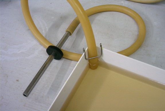

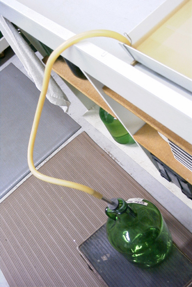

I'll second the siphon method. Cheap and foolproof.
Instead of plastic tubing, latex (gum) rubber tubing is more flexible.
A simple clip bent from a piece of stainless welding rod holds one end in the tray.
A metal tube in the outlet end, with a large rubber washer keeps it from falling into the bottle.
