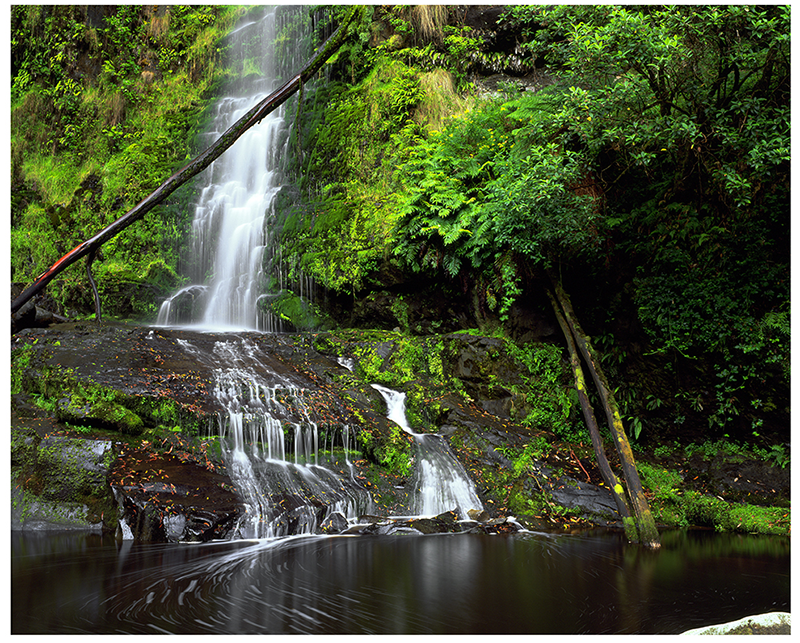

"Slightly softer contrast" for a film (RVP) that beats contrast to the max? Good luck with that. But there are some pokes to play with...
Giving Provia 100F a gentle pull or shove is fairly common practice, and Provia does not have the high contrast and narrow range of Velvia, so it will happily sail through most situations that it's bigger brother will scowl at. It's important to keep in mind that Velvia is not a universal film for all situations (as much as negative film can be and often is), this being the point that brings a great many users undone and onto the warpath with it. But the strife is not all Velvia's fault! :wink:
If you want to "slightly" enhance Velvia, tweak the ISO to EI40 or EI32. In either case, your exposure must be substantially reduced to preserve highlights while opening (only very marginally) shadows. I deal with Velvia by flattening spectrals (polarising) to assess highlights and shadows with a spot meter and then decide whether it should be lifted; it is not very common. I never bother P/P with Provia because it is a fine emulsion as it is (used for my pinhole work and a stand-in if I should somehow forget to pack RVP).
RVP50 / EI40 (no processing change), hazy-to-bright sun in amphitheatre.

Thanks for your thoughtful answer!
Actually I don't want to pull the film only to reduce contrast, but also to slightly change the texture of the picture. Ideally I would like the colors that offer Provia, with a more painterly texture, something that breaks a bit the extreme sensation of reality that we have with slide film. That's why I was asking about pulling. Of course there are other things, like working with older lenses or slightly move the tripod during the exposure etc...
I also remember some things Kubrick did for Barry Lyndon and Eyes Wide shut, pushing the film and shooting with a low contrast filter. It gave him rich colors but a soft texture. And a lot of grain, which I don't want, but we can't compare Provia to a 500 asa negative :smile:
Often, Velvia is too much for me. I love the colors but it's too contrasty, too sharp... I use it only when the light is very, very soft.
