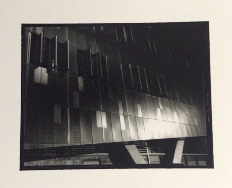

So I tried it out, and while wandering around with a non-photographer friend of mine at 4:30am, setting up this photo, the zone system finally clicked for me. I was metering the scene, and took a digital proof shot to see if the light was in fact falling as I believed it to. I was explaining what I was doing to him, and then *click* I finally understood.
I decided to forgo the yellow-green filter and stick with straight exposures as not to overly complicate things. At the end of the day, I have a while to experiment, but I needed to shoot useable exposures for a final of mine at school. I decided to simply rate the film at 50ISO and develop for 50 Iso with slight over development (+1 minute) in a 1+75 dilution of Rodinal.
Please excuse the horrible photo of a direct contact print on warmtone FB paper. I'll be burning in the highlight on the bottom right corner just to bring in the detail. I'm also looking into selenium toning the final print, but my school doesn't allow toning in the facilities.
Cool. Staying very close to normal worked pretty good it looks like.
Couple thoughts,
Skipping the extra minute might have eliminated the need to burn in the highlights. Maybe try a slightly softer paper grade with this negative..
With regard to ZS metering, glad you got it. Just understand that it's a guide, an estimation not an absolute. There are lots of variables, in the real world it's not as exact as one might think, but it will get you in the ball park.
