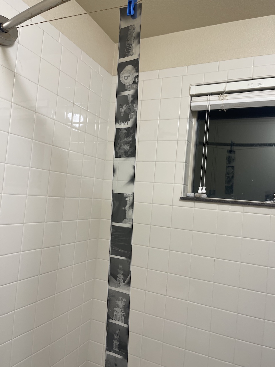

MF film comes in a wrapper for a reason. It’s not just to look pretty. If you store your 120, and ESPECIALLY 220, in daylight for more than a couple hours, you WILL get light leaks. This was a roll of Foto 100 that I meant to load into my camera right after making, but unfortunately life happened and it got left on the desk, unwrapped, for 3-4 days.
If you shoot MF film, and especially old aerial films (Rollei films, Aerocolor, my films), keep that wrapper on until you are READY TO LOAD.
I made this mistake (twice now, actually) so you don’t have to.

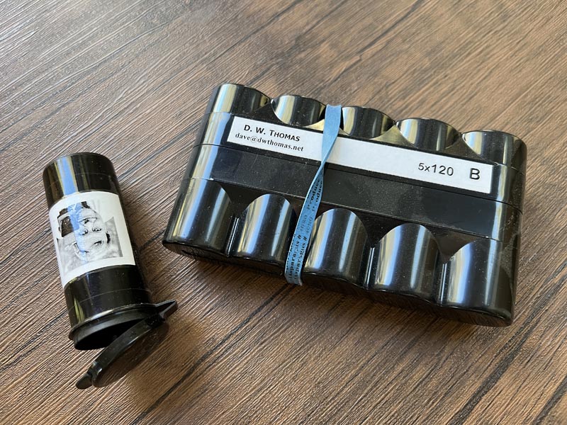

I've accumulated a few of these. The single container used to come with some films (from Maco?) and could be purchased from Freestyle, but I fear they've dried up. The five-roll pack is a "Japan Camera Hunter" brand.
To my amazement, I just now looked at B&H and there is a Kodak branded single container!
These thingies fit a roll in the foil wrapper, so one can put new rolls in to start and swap exposed stuff in (with maybe a sticky flag to keep track).
(Excuse the frivolous and vain ID labels. I figure if my name and contact info is all over them, airport people might be less suspicious.)

I have a bunch of those single roll containers--they come on Foma 320 Retropan and 400 Ortho. The 5 roll holders and identical 10 roll holders (2 rows of 5) are available form numerous locations. I bought mine on ebay from chinese sellers, but you can get them lots of places.
I have a handful of those , used them all the time for exposed film.
I too use the five roll carriers and I quickly found that the light leaks from the exposed rolls not being tightly rolled or the tape loosened up completely stopped. Now also put a strip of blue painters take on each carrier so that if the rolls sealing tape does not hold, I tear off a piece of the painters tape to keep to roll tightly rolled. Do not use rubber bands to hold rolls closed, because it the rubber bands are too tight, their pressure will cause marks on the negatives.

The roll was loaded and unloaded correctly. I think that sitting in room light for that long really messed it up. Especially with it being 220 and having an ultra-clear base, both risk factors for light piping.

Yes, 220 is especially susceptible, but this can also happen to 120 given enough time.

This is not correct. Unfortunately, we cannot make a 100% light tight seal on the edge of a roll of 120 or 220. There needs to be a slight tolerance so that the paper can move past the edge of the spool. And, as mentioned in the post above, clear PET is extremely susceptible to light piping. Any small light leak between the paper and spool, given enough time, will cause issues. This is specifically why this film comes wrapped, and why it should not be taken out of the wrapper prematurely.
