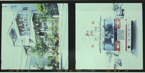

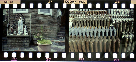

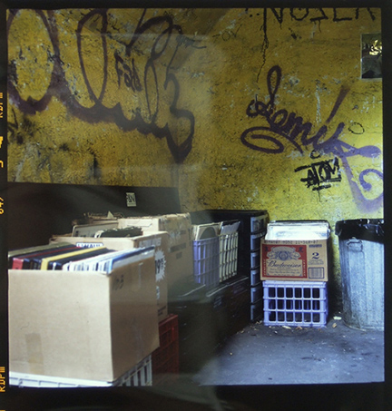

Sounds like from all are saying, I need to try again, and be more conservative metering the highlights. For your amusement, I did manage to make a rough "scan" by photgraphing the film on a light table (with some reflections from the sleeve):
The first is the "normal" exposure Provia, then the "underexposed" Provia, then the normally exposed Kodachrome.

Looks like you just placed your highlights too high on the daylight scenes with the Kowa.
It's also possible, if you used the same meter for the Kodachrome shots, that your Kowa shutter speeds (or at least some of them) are on the slow side--slide film will reveal such problems.

The sample Provia frames look well over, however the other films look OK. Does anyone think that it might be a processing issue?

I don't see any real bright areas of the scene that would have fooled the meter to be off that much. I think you had the meter set for the wrong ISO.
