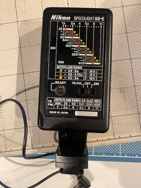

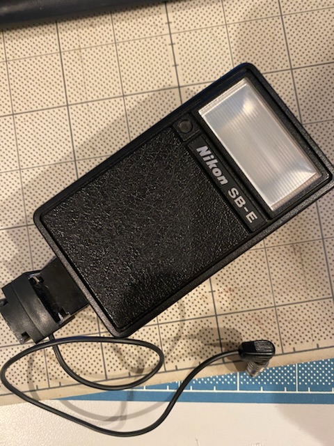

I have a Nikon SB-E

The Nikon SBE is an 'auto' mode flash, using a built-in photosensor to read light reflected back from the scene to determine when to turn off flash output providing 'proper' exposure.
If you
  • place your camera with lens at 'same FL' every time,
  • at a consistent distance from the subject,
  • and the subject is placed in front of a consistent background,
  • and use a consistent aperture size and shutter speed,
you should get consistent exposures from session to session.

That flash will be consistent in your application as long as you ensure that it is set correctly for the camera model distance between flash to subject. It will automatically correct for session-to-session "consistency" deviations. Ensure that your aperture is set correctly for the film speed you are using and proper synch speed (or slower). Use fresh batteries.
In casae you don't ahve the manual already:

One last thought for your consideration. The SB-E is a very low powered strobe and has rather limited maximum distance. Before committing to that strobe for your project ensure that the framing distance you desire will be within that constraint. A higher-powered strobe might be worth considering.
Given that the SB-E is designed to work with a couple of old Nikons and you are using a Pentax, which may limit you to a 10 foot distance, another simple-affordable strobe like a Vivitar 283/285 might be a better option. At GN 80 or so you’ll not have many limitations to worry.
The SBE Guide Number is 17 meters...that equates to 58 feet. If you shoot 7' from the subject, you use f/8 with ISO 100 film if flash is fired at full power.
However the SBE does not have a Manual mode, its operation always uses its photosensor Auto.

Looking at the label on back of meter, the FE/FM setting is used for all but Nikon EM cameras. The auto flash range (2 to 10 feet) doesn’t indicate quite as much light being produced as you suggest. Whatever it might produce in a manual mode is a moot point.
10 feet maximum is a bit limiting.
But if you are contesting my use of the term “very low power” then I understand. It is lower power than some other alternatives was my intended point. :smile:

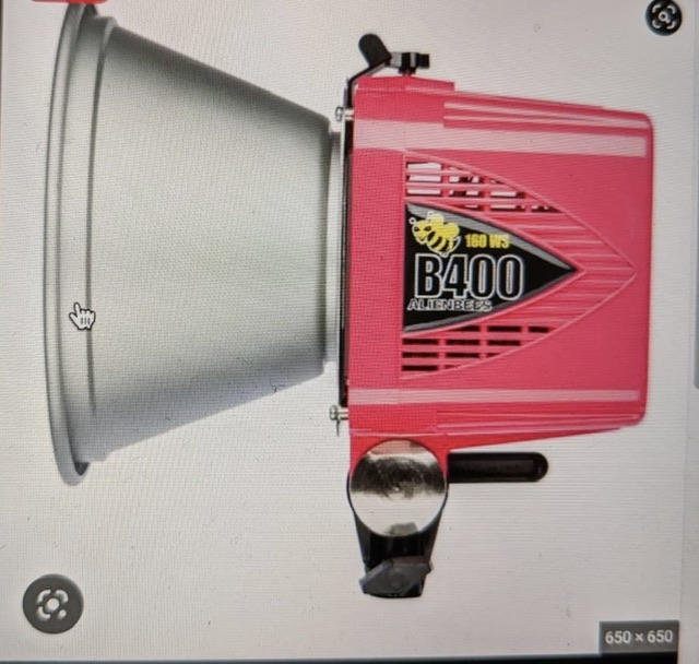

The other light option I have is the attached one. No idea how to use it but I can get it used from a friend for cheap.

Run a test to verify that your equipment and setup will perform as you desire. You shouldn’t have a problem with the SB-E if you like the look of a camera-mounted and/or unmodified strobe.
The Alien Bee, or other strobe, could give you option to bounce or soften the strobe light a bit. It depends on what look you want to achieve.

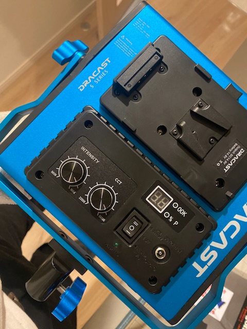

A buddy of mine gave me a LED constant light source and a stand. I will get the alien bee strobe above with triggers from him as well. Also got stands for a backdrop from him. The only thing I need is the backdrop itself. Looks to be $50 or 6,600 yen here.
Anyways, the LED seems easy to control but doesn’t have enough power for a 100 speed film.
I’ll try with the strobe next. I’ll try to cut all ambient light out and then only light with the strobe. I have a digital body I can use to meter and test exposure.
I love the lightbulb idea too but have a feeling that’ll be even weaker than the LED light source.

Well, the LED has a setting for temperature. I assume for Provia 100f I’ll set that to 5600 Kelvin?!
Oooooohhh... that's where I'd start with some tests. That, and some diffusion. Can't wait to hear what kind of exposure you can get at 100 ASA. Easily measured with an incident light meter. Nice option for your project!
Camera on tripod? That would also make it slightly easier to replicate the exact same scene every time, wouldn't it?
Depends a bit on your taste. I'd personally start at 5000 and take it from there. 5600 would probably be a tad cool to my own taste, but I tend towards somewhat warmer images much of the time.
