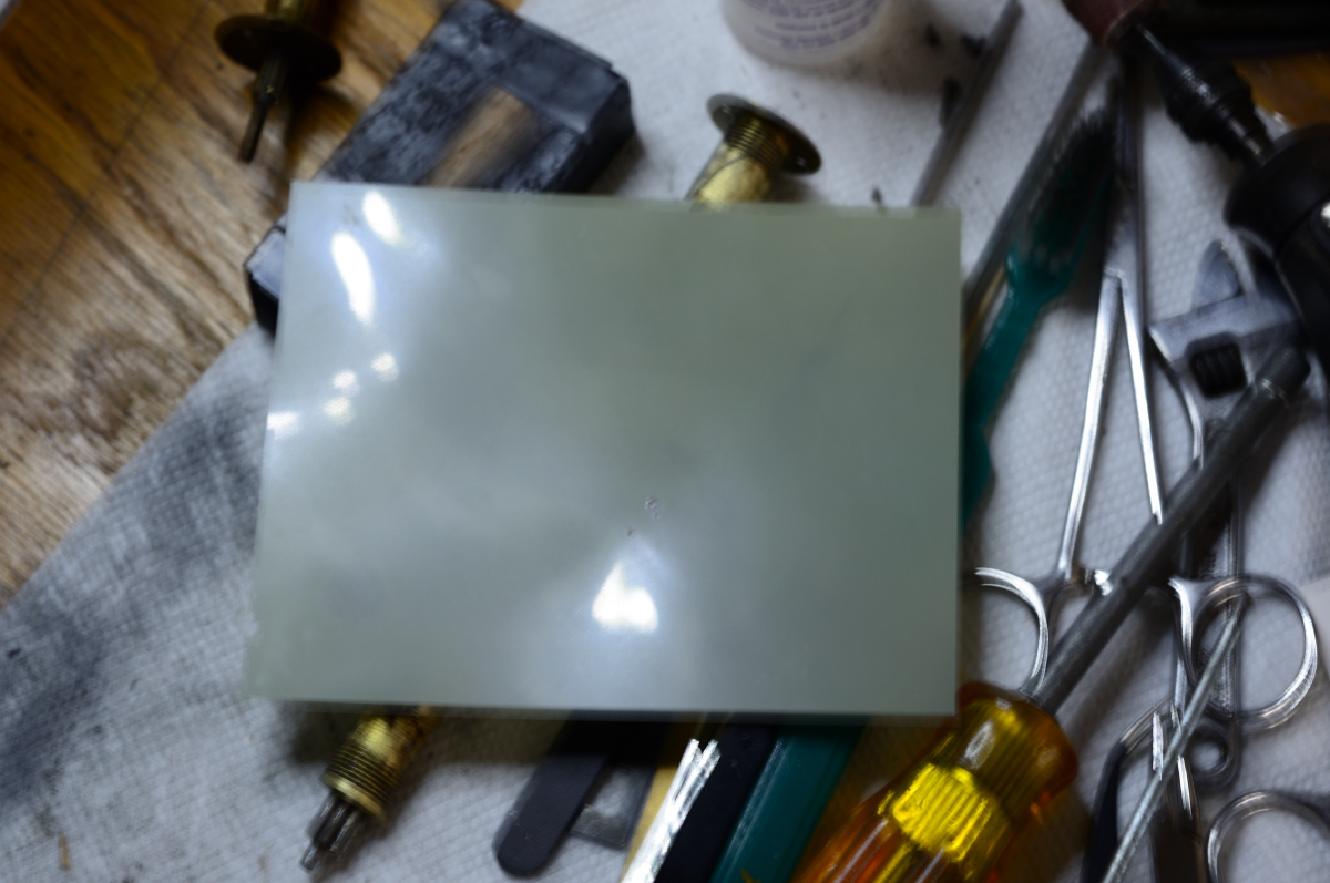

shutterfinger
Feb 25, 2013
5,020
San Jose, Ca.
The sun as viewed through a shht of film left out in the day light.
Yes its overcast from the SCU and SCZ fires.
The sheet of film
The sun shot took all of 3 seconds. I prefer the moon but its not always available and loading up the camera, tripod, and tools to set up infinity and driving several miles to get a good infinity target is not a viable option. I have set up infinity on cameras and rangefinders using a target about 3/4 to 7/8 mile away and celestrial objects are not in perfect concidence when viewed through such a camera or rangefinder.
Again do not look at the sun directly and only for less than 15 seconds with a very strong filter. 2 layers of this film completely block the sun on a perfectly clear day.
