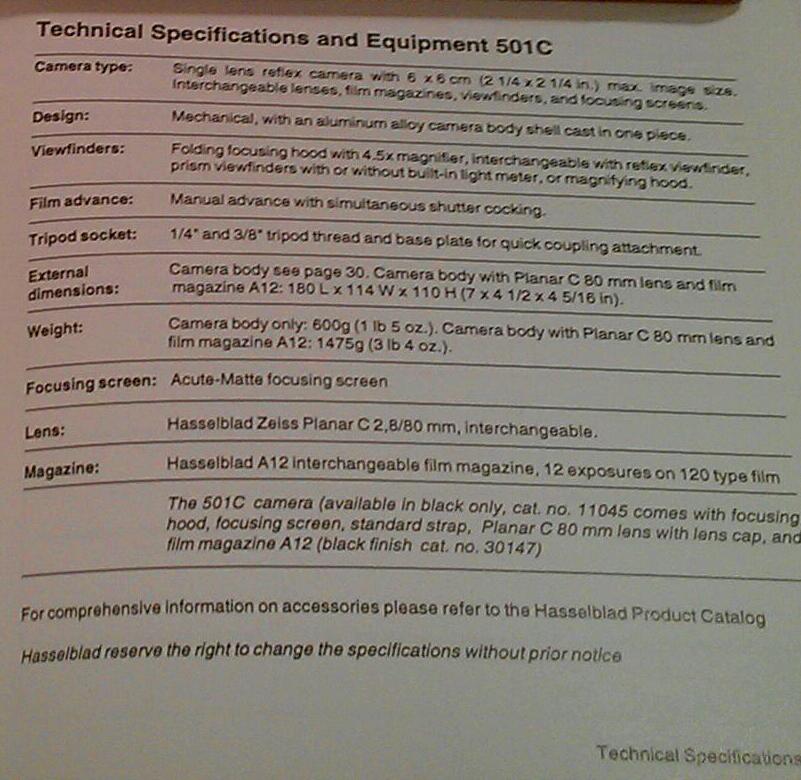

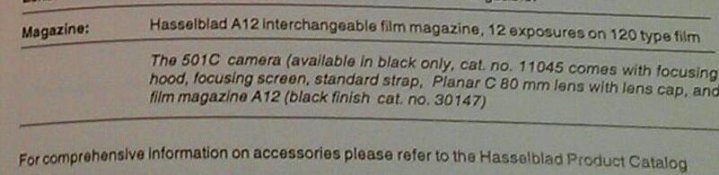

The 501c would have come with the latest version of the A12, the one with the built-in darkslide holder on the back.
Perhaps later, but in 1994 they did not. This is evident by the illustrations throughout the owner's manual. According to The Hasselblad Compendium by Rick Nordin, page 166, the slide holder was added to the A12 in 1997.
What I show here is my owner's manual from 1994. You can see in the text of the fourth photo that the catalog number for the black A12 back used with the 501C is 30147.

Dear Bill,
1994 would be an A12 II which would have a date code matching your body, although sets from new sometimes had date codes that were different.
The model code in black trim (chrome was not supplied with the body) was 30147, in the 1997 catalogue when the the A12N back was introduced and the 501C was still available, it is clearly stated the 501C is supplied with the back that does not have the magazine holder although that was now avaialble.
