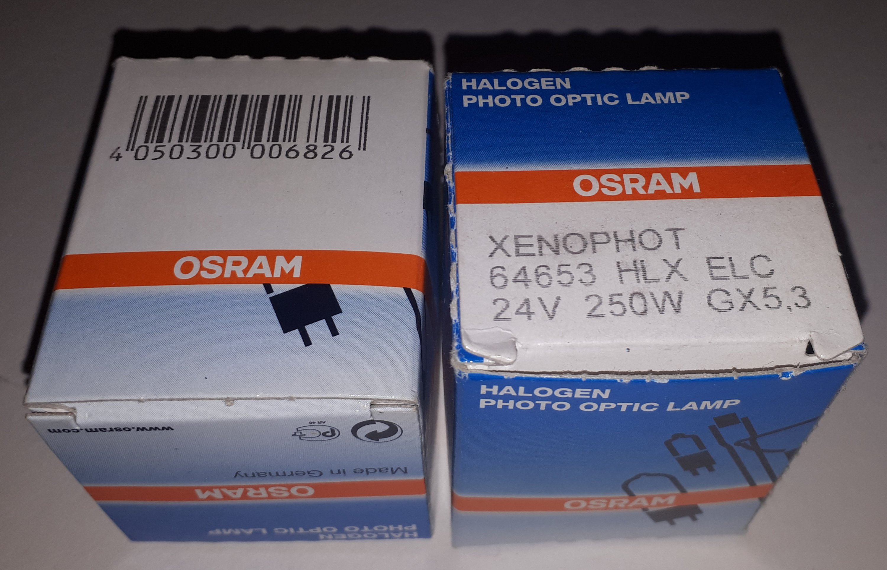

Looking for recommendations on quality bulb for Durst L1200 (CLS 450 head to be clear).
I see several from Osram, GE and others. Basic specs being 24V, 250W, GX5.3 but that is not all. I also noticed color temperature being 3000-3500 K on all offerings and thought it would have to be closer to 5000 K, no?
Main point, what are you using ?I won't splurge on so-called Durst bulbs, I know I don't need to).
Deleted member 88956
For the time being I'm considering one below, but am wondering of other options. GE does not seem to be available here, there are some Phillips offerings.
OSRAM 64653 HLX ELC HALOGEN XENOPHOT GX5.3 24V 250W

I've tried most of the lamp brands in various Durst enlargers and the only difference I've noticed is the exposure times between new and old lamps.
You don't want or need daylight colour temperature lamps.
that's what I'm using. I believe the current temperature is normal for halogen bulbs.
