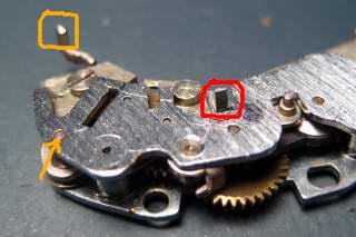

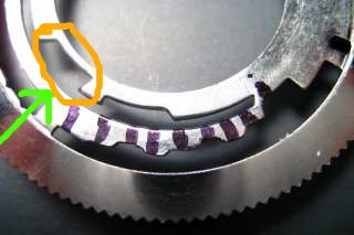

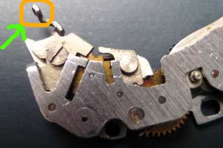

I've taken someone else's images of the mechanism and made some marks on them to discribe what is happening.
The tab (orange circle in the picture of the escapement) should move into the notch (orange circle in the image of the "cam") in the direction of the green arrows when set to the speeds noted above. It will not do this on its own though. If I cock the shutter and it is in timer mode, I have time to place light pressure on this tab when the shutter fires. When I do this, voila, the tab goes where it should and I get a resonable facsimilie of whichever of those speeds I've chosen.
Unfortunately it only does this when I push on it. Which leads me to believe that there's a spring either missing, broken, or not engaged with something.

A. The low speed mechanism is not engaging. One possible cause is that the low speed pallet (who's tab is circle in orange) is not pivoting into position. The pivot point (orange arrow) may merely need cleaning. However in this particular case the pivot shaft was so rusty that it was pitted. Removal and polishing of the shaft did return some motion, but a replacement will ultimately need to be sourced.
Do keep in mind that there are several versions of the SVS, so I can only state with certainty that it applies to those shutters who's cams look like the one pictured in my previous post and have speeds B,1,2,4,8,15,30,60,125,300. The low speed mechanism is only involved in 1,2,and 4. A mid speed pallet (red circle) is used for 8,15, and 30. Neither are involved in 60,125 or 300.
