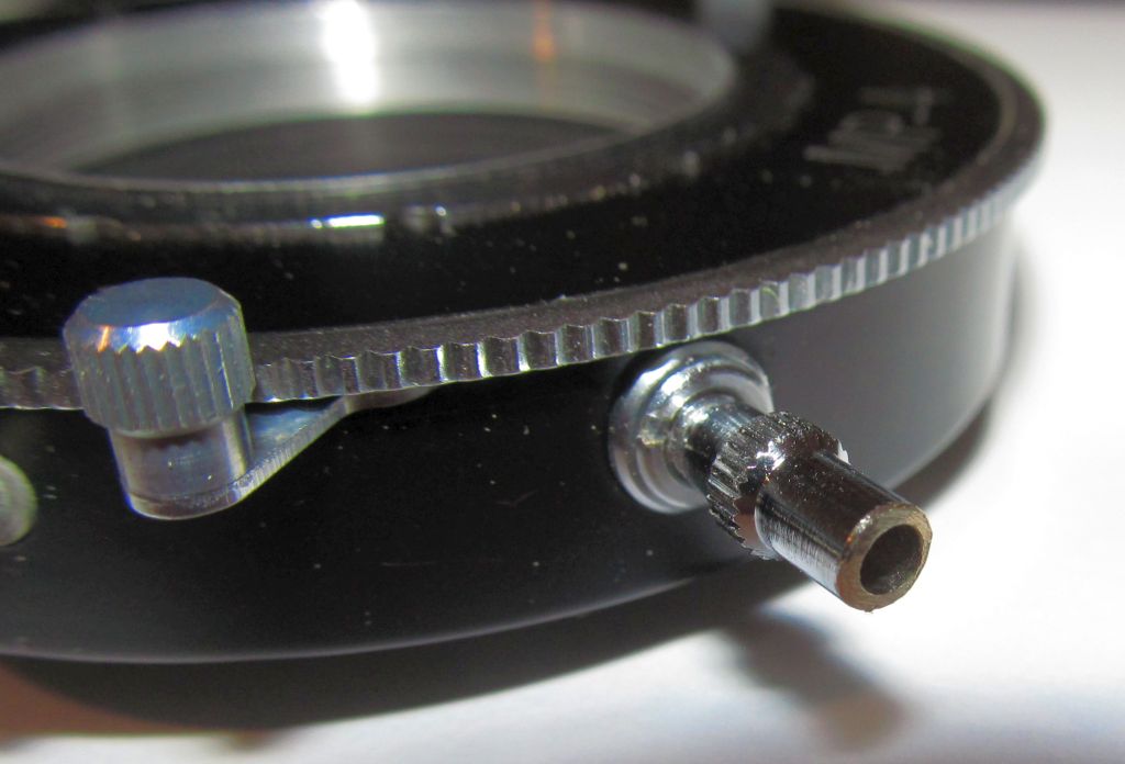

Hub=The distance the pin is coming out when pressed completely.
I am just trying out on my Polaroid MP4 copal 1 shutter. also have the similar Wista. i can trigger but timer not working.
forgot to tell that its on Agfa Clack where the Hub must be small to no trigger before shutter is opened. Maybe i am totally offset.
I dont need a timer in pinhole-cam, rather in one with Zoneplate/Zonesieve. So it could be on my Kiev60, will just test, wait a minute. maybe better getting first shooting-experience before brainstorming the wrong way.
NB: i "killed" seperate Mamiya RZ67 180mm tubes when fiddling around with mechanisme without cam. be cautious 3 screws are holding the tubes in slits rather than in holes.... for easy servicing. no good idea!
3dreal
Aug 31, 2017
67
Basel

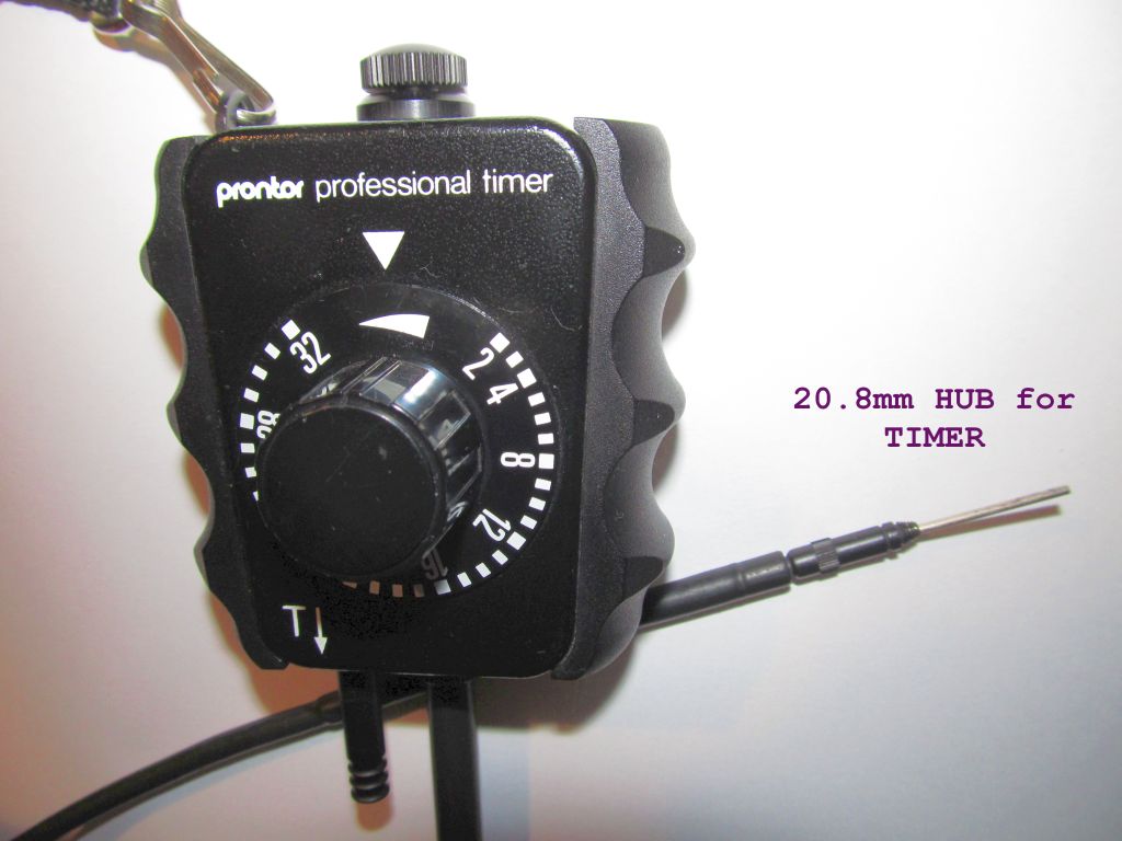

can tell you now where the problem is with Prontor Professional Timer(the newest black one) used on Copal 1-shutter.
Total pin out is 20.8mm that is full pressing when timer will work.
Without timer i must press 9,8mm approx. to activate shutter. so there is a difference of 11mm when must be adjusted by a double-threaded tube, whats the tread-size of standard cable-releases? I only wonder if it matters that the pin is looking out 3mm. do we have to add this in the calculation? an electro-mechanic bluetooth-timer would be hot! Kiev60 has 1/2 sec and B. 1-2 sec are hard to handle manually. if only one could attach a metronome with earphones. a contact added outside between the button and time-case. enough space. next time i will show images of the timer. it has also T-option. 2-32 sec in standard setting.
I want to shoot 2-32 secs. exposure times for whatever images with Prontor Professional Timer(cable release).
I am pressing the timer button when cable-release is on copal 3 in B-mode.
1. shutter will open and stay open even when timer set to whatever setting 2-32 secs.
2. timer is not activated since the shutter is released too early. when shutter is open cable cannot be moved further. button is stuck "halfway" at the distance i calculated and measured. to reach timer-point a double-thread-tube with matching size must be attached. most be fabricated. i have an angled, a u-shaped and flexible prolonger but it has pin inside. will try to crack/open the latter.
In T-Position to keep the Hub.
will now open the plate since i cannot turn the screw. and dont want to risk a break.
